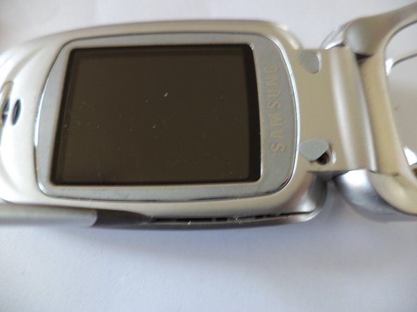

  1. Samsung SGH-X450 Teardown, Samsung SGH-X450 Teardown: crwdns2935265:01crwdnd2935265:01crwdnd2935265:01crwdne2935265:0
    • Take out the battery and SIM Card.
  2. Samsung SGH-X450 Teardown: crwdns2935265:02crwdnd2935265:01crwdnd2935265:01crwdne2935265:0
    • Remove these screws.
  3. Samsung SGH-X450 Teardown: crwdns2935265:03crwdnd2935265:01crwdnd2935265:01crwdne2935265:0
    • If the screws are removed, you can take the case of with your fingers or a small flathead screwdriver
  4. Samsung SGH-X450 Teardown: crwdns2935265:04crwdnd2935265:01crwdnd2935265:01crwdne2935265:0
    • Now you see the PCB
    • Agere TR09WQTEF2B Processor
    • Agere PSC2106 Power Management IC
    • Battery contacts and power supply connector
    • SIM Card Slot
    • Back-Up battery
    • Antenna connector
    • 2,5mm Headphone Jack
  5. Samsung SGH-X450 Teardown: crwdns2935265:05crwdnd2935265:01crwdnd2935265:01crwdne2935265:0
    • LCD Dispaly cable, you can release this connector with a small flathead screwdriver
    • Be careful here, You can break the flatcable!
  6. Samsung SGH-X450 Teardown: crwdns2935265:06crwdnd2935265:01crwdnd2935265:02crwdne2935265:0 Samsung SGH-X450 Teardown: crwdns2935265:06crwdnd2935265:02crwdnd2935265:02crwdne2935265:0
    • To take the LCD display out of the case, click the upper case open with a small flathead screwdriver or case opener. Under the two pads under the LCD Display are 2 screws.
    • Be also careful here, go not to far with the screwdriver so you can not damage the LCD display.
  7. Samsung SGH-X450 Teardown: crwdns2935265:07crwdnd2935265:01crwdnd2935265:01crwdne2935265:0
    • Now you see this.
    • If you want to remove the LCD display, lift the PCB of the LCD display up with a small flathead screwdriver.
  8. Samsung SGH-X450 Teardown: crwdns2935265:08crwdnd2935265:01crwdnd2935265:01crwdne2935265:0
    • Finished!
