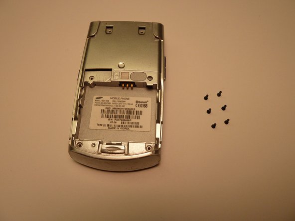

    • Locate the six (4mm) screws on the back of the phone.
    • Unscrew all six screws using a Phillips head #000 screwdriver.

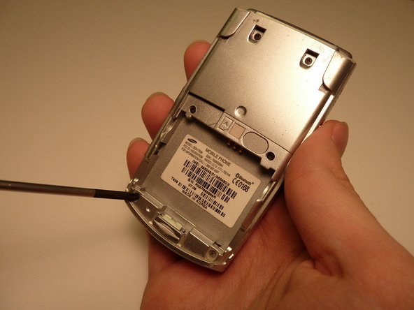

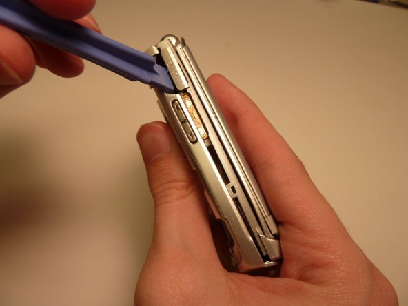

    • Locate volume button.

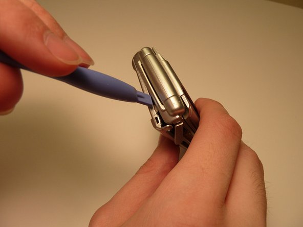

    • Starting at the top, pry the back casing of the phone.
    • Continue prying around the side of the phone. Being careful around the volume button.

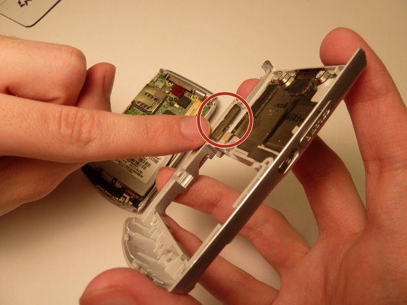

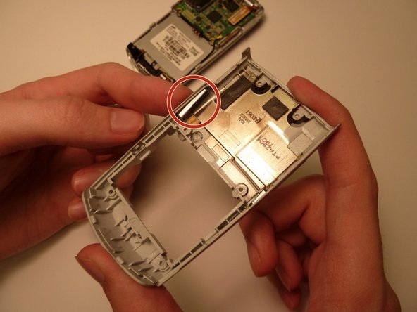

    • Remove back casing from the phone.
    • Relocate the volume button.
    • Gently push the volume button towards the interior of the back casing of the phone.
  7. Samsung SGH-T639 Volumn Button Replacement: crwdns2935265:07crwdnd2935265:01crwdnd2935265:01crwdne2935265:0
    • Completely remove the volume button from the cell phone.
