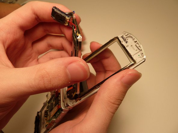

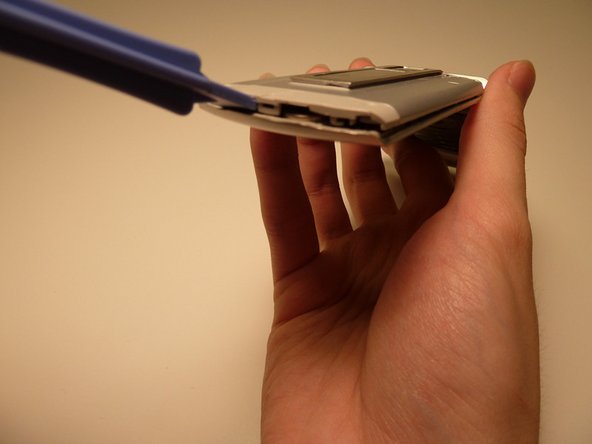

    • Locate the seam of the casing along the edge of the phone.
    • Starting at the end, gently begin to pry the front casing away from the phone. Use the plastic opening tool for this step.
  4. Samsung SGH-T639 Screen Replacement: crwdns2935265:04crwdnd2935265:01crwdnd2935265:03crwdne2935265:0 Samsung SGH-T639 Screen Replacement: crwdns2935265:04crwdnd2935265:02crwdnd2935265:03crwdne2935265:0 Samsung SGH-T639 Screen Replacement: crwdns2935265:04crwdnd2935265:03crwdnd2935265:03crwdne2935265:0

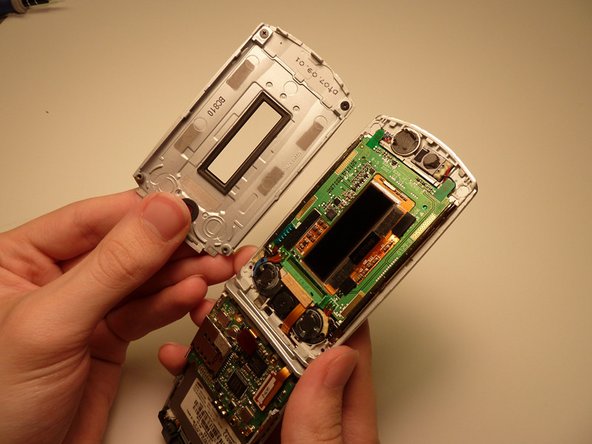

    • Continue to pry the casing from the front of the cell phone.
    • Remove front casing from the cell phone.

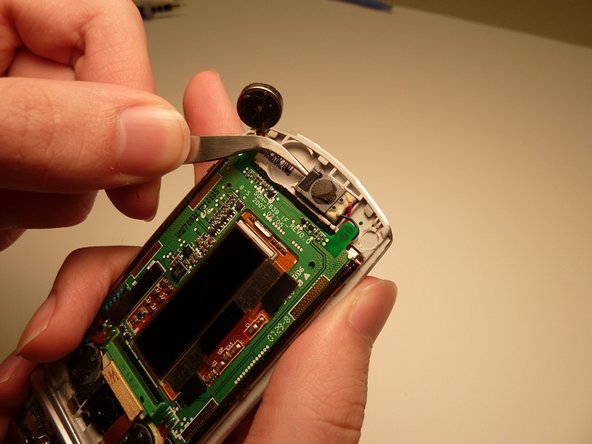

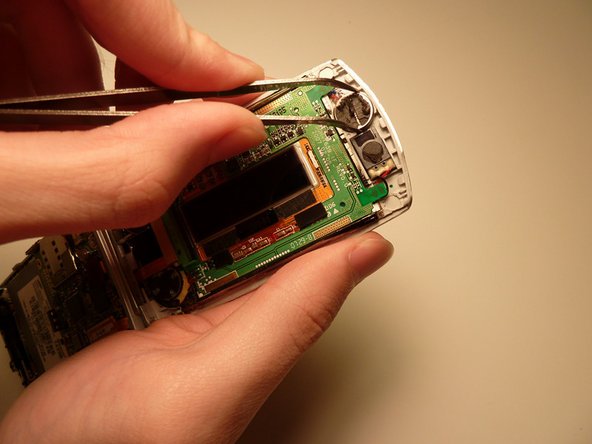

    • Locate the small battery at the end of the cell phone.
    • Gently remove the battery from the cell phone using tweezers.
    • Note: This may require some force.
    • Do not disconnect the battery from the entire phone. Simply lift the battery from the cell phone while keeping the wires connected.

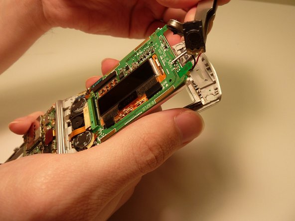

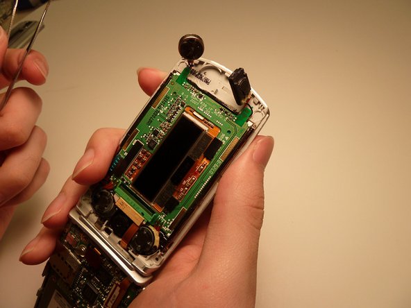

    • Locate the speaker at the end of the cell phone.
    • Gently grasp and lift the speaker from the cell phone using tweezers.
    • Do not disconnect the speaker from the entire cell phone. Simply lift the speaker while leaving the wires connected.

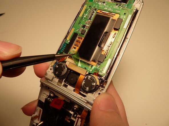

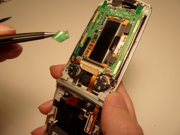

    • Locate the tip of the sheer protection film.
    • Gently lift and remove the protection film with tweezers.

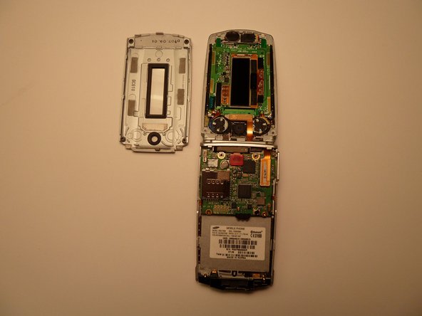

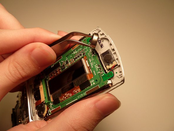

    • Locate the top tabs of the screen and circuit board unit
    • Gently lift the screen and circuit board as one unit from the cell phone using the tweezers.
    • Make sure the screen and circuit board are removed as one unit. Do not disconnect the screen from the circuit board.

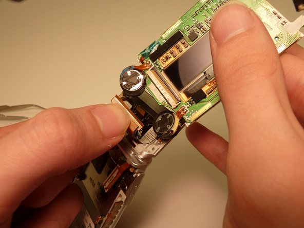

  9. Samsung SGH-T639 Screen Replacement: crwdns2935265:09crwdnd2935265:01crwdnd2935265:03crwdne2935265:0 Samsung SGH-T639 Screen Replacement: crwdns2935265:09crwdnd2935265:02crwdnd2935265:03crwdne2935265:0 Samsung SGH-T639 Screen Replacement: crwdns2935265:09crwdnd2935265:03crwdnd2935265:03crwdne2935265:0

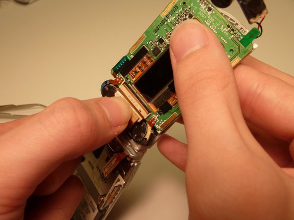

    • Locate the gold connector that is attached to the circuit board.
    • Pull the connection away from the circuit board.
  10. Samsung SGH-T639 Screen Replacement: crwdns2935265:010crwdnd2935265:01crwdnd2935265:01crwdne2935265:0
    • Completely remove the screen and circuit board unit from the cell phone.
