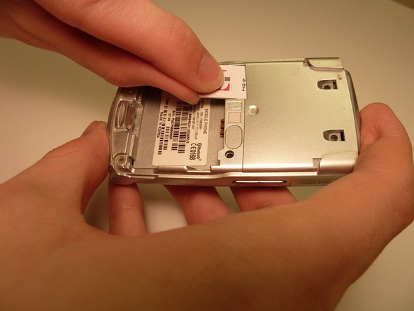

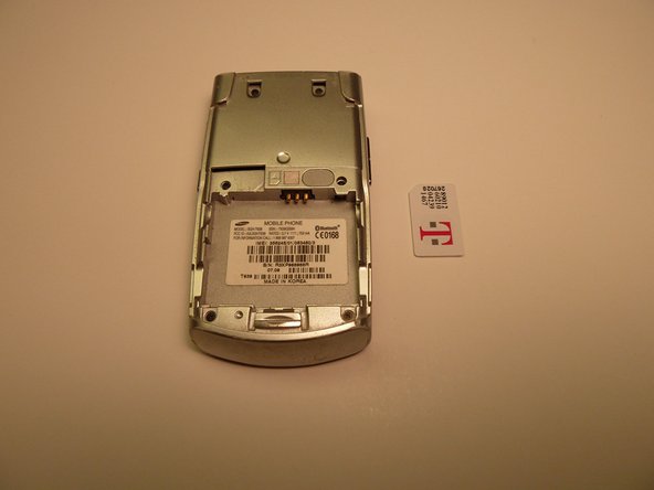

  3. Samsung SGH-T639 Keypad Replacement, SIM Card: crwdns2935265:03crwdnd2935265:01crwdnd2935265:03crwdne2935265:0 Samsung SGH-T639 Keypad Replacement, SIM Card: crwdns2935265:03crwdnd2935265:02crwdnd2935265:03crwdne2935265:0 Samsung SGH-T639 Keypad Replacement, SIM Card: crwdns2935265:03crwdnd2935265:03crwdnd2935265:03crwdne2935265:0
    • Locate SIM card
    • Slide SIM card down and gently pull out of the card slot
