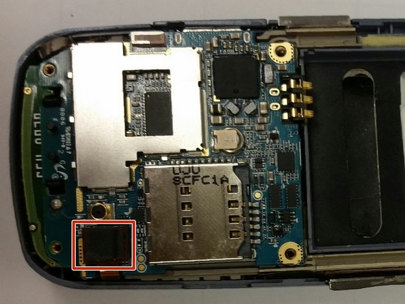

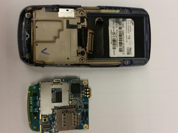

  5. Samsung SGH-A737 Camera  Replacement, Circuit Board: crwdns2935265:05crwdnd2935265:01crwdnd2935265:02crwdne2935265:0 Samsung SGH-A737 Camera  Replacement, Circuit Board: crwdns2935265:05crwdnd2935265:02crwdnd2935265:02crwdne2935265:0
    • With care, lift up the connector located at the bottom left of the phone, as demonstrated in the accompanying image.
  6. Samsung SGH-A737 Camera  Replacement, Circuit Board Continued: crwdns2935265:06crwdnd2935265:01crwdnd2935265:02crwdne2935265:0 Samsung SGH-A737 Camera  Replacement, Circuit Board Continued: crwdns2935265:06crwdnd2935265:02crwdnd2935265:02crwdne2935265:0
    • Flip the circuit board up to unveil an orange connector near bottom of it.
    • Gently unplug the connector by prying on the corner with a finger.

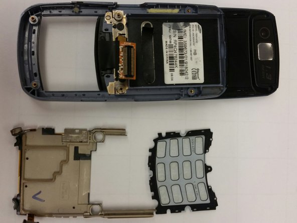

  7. Samsung SGH-A737 Camera  Replacement, Circuit Board Holder: crwdns2935265:07crwdnd2935265:01crwdnd2935265:02crwdne2935265:0 Samsung SGH-A737 Camera  Replacement, Circuit Board Holder: crwdns2935265:07crwdnd2935265:02crwdnd2935265:02crwdne2935265:0
    • Lift up the tan circuit board holder to separate it from the device.

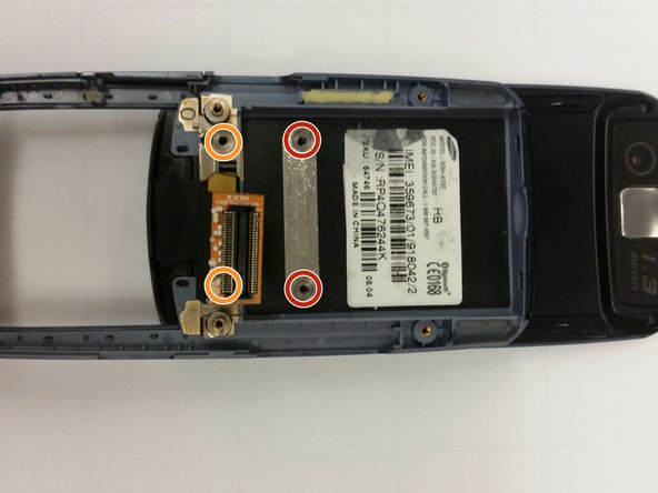

  8. Samsung SGH-A737 Camera  Replacement, Sliding Panel: crwdns2935265:08crwdnd2935265:01crwdnd2935265:02crwdne2935265:0 Samsung SGH-A737 Camera  Replacement, Sliding Panel: crwdns2935265:08crwdnd2935265:02crwdnd2935265:02crwdne2935265:0
    • Peel off the black strip below the product sticker, unveiling two screws and unscrew them.
    • There are two more screws slightly below that need to be unscrewed as well.
    • Be sure to use the proper size screwdriver. Using the wrong size can cause damage to the case!

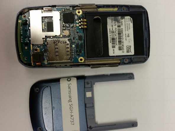

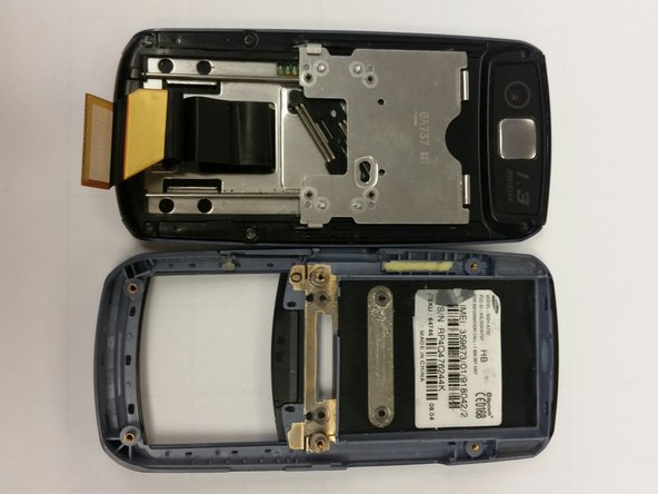

  9. Samsung SGH-A737 Camera  Replacement, Sliding Panel Continued: crwdns2935265:09crwdnd2935265:01crwdnd2935265:02crwdne2935265:0 Samsung SGH-A737 Camera  Replacement, Sliding Panel Continued: crwdns2935265:09crwdnd2935265:02crwdnd2935265:02crwdne2935265:0
    • Make sure the phone is closed. If not slide it closed now.
    • Next, carefully detach the blue plastic panel from the phone. It should already be slightly loose.
    • When sliding the connector through the rectangular gap, be sure to do so gently in order to avoid any damage.

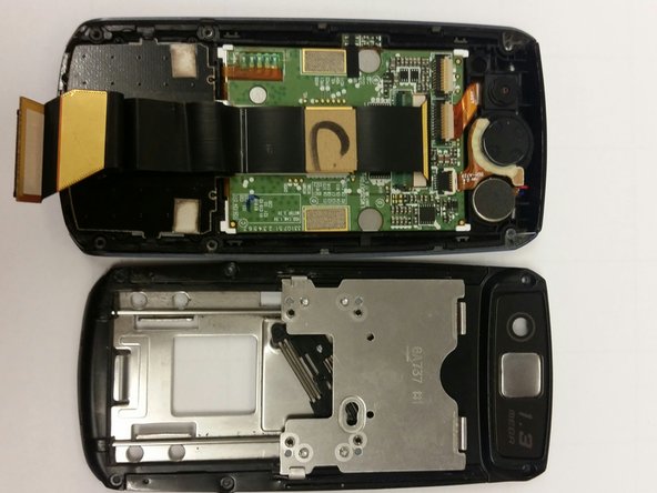

  10. Samsung SGH-A737 Camera  Replacement, Camera Panel: crwdns2935265:010crwdnd2935265:01crwdnd2935265:02crwdne2935265:0 Samsung SGH-A737 Camera  Replacement, Camera Panel: crwdns2935265:010crwdnd2935265:02crwdnd2935265:02crwdne2935265:0
    • Begin by removing the six visible screws located on the outer edge of the device.
    • Once the screws are removed, gently separate the panel to unveil the circuits and camera.

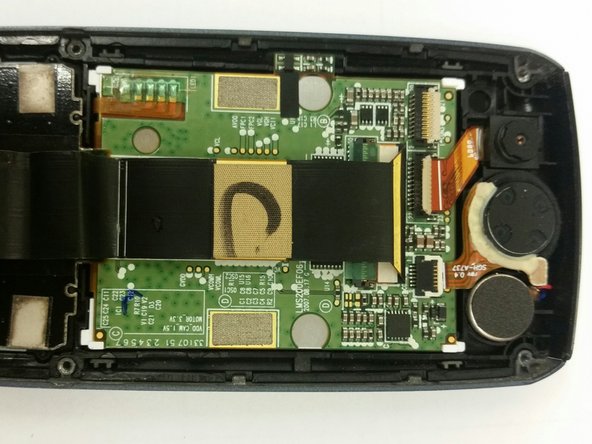

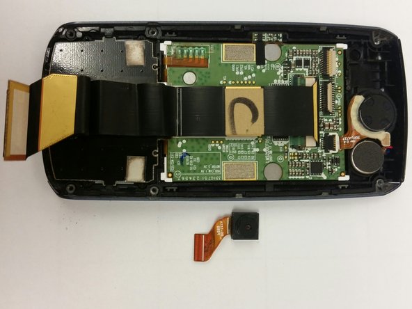

  11. Samsung SGH-A737 Camera  Replacement, Camera Replacement: crwdns2935265:011crwdnd2935265:01crwdnd2935265:03crwdne2935265:0 Samsung SGH-A737 Camera  Replacement, Camera Replacement: crwdns2935265:011crwdnd2935265:02crwdnd2935265:03crwdne2935265:0 Samsung SGH-A737 Camera  Replacement, Camera Replacement: crwdns2935265:011crwdnd2935265:03crwdnd2935265:03crwdne2935265:0
    • Be sure to perform these steps using as little force as possible. The circuit boards can be delicate!
    • To disconnect the camera, gently lift the tan flap away from the camera where the orange connector is attached. This should loosen the wire.
    • Next, pry up on the camera to dislodge it. This may require some force.
