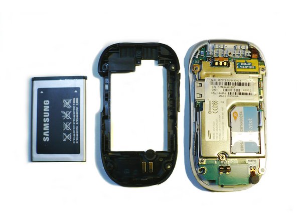

    • Place phone face down so battery cover is showing.
  2. Samsung SGH-A237 Keypad Replacement: crwdns2935265:02crwdnd2935265:01crwdnd2935265:02crwdne2935265:0 Samsung SGH-A237 Keypad Replacement: crwdns2935265:02crwdnd2935265:02crwdnd2935265:02crwdne2935265:0
    • Use thumb to push the cover down and off.
    • Lift battery cover off the device.

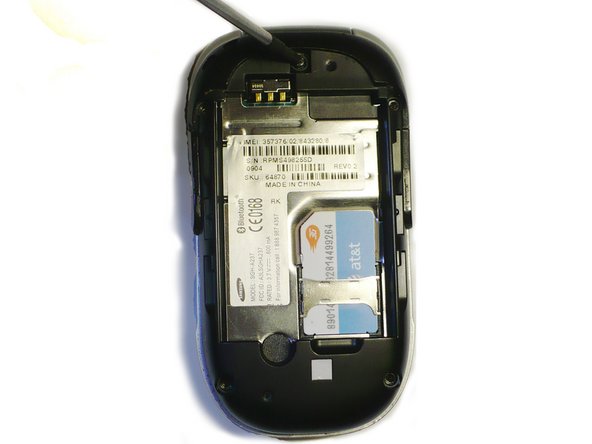

  3. Samsung SGH-A237 Keypad Replacement: crwdns2935265:03crwdnd2935265:01crwdnd2935265:02crwdne2935265:0 Samsung SGH-A237 Keypad Replacement: crwdns2935265:03crwdnd2935265:02crwdnd2935265:02crwdne2935265:0
    • Remove the five screws with a size 00 screwdriver. There are 4 in the corners and one on the top as shown.

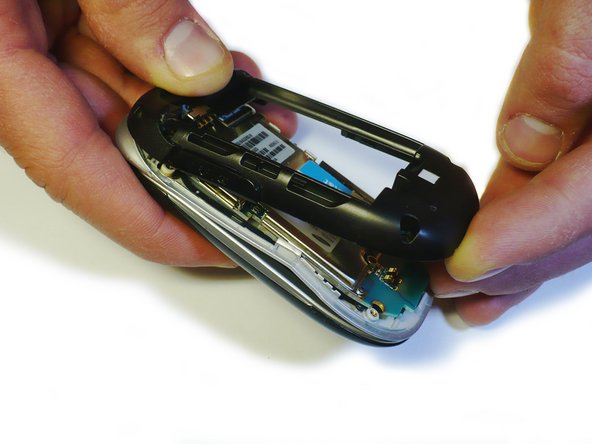

  4. Samsung SGH-A237 Keypad Replacement: crwdns2935265:04crwdnd2935265:01crwdnd2935265:03crwdne2935265:0 Samsung SGH-A237 Keypad Replacement: crwdns2935265:04crwdnd2935265:02crwdnd2935265:03crwdne2935265:0 Samsung SGH-A237 Keypad Replacement: crwdns2935265:04crwdnd2935265:03crwdnd2935265:03crwdne2935265:0
    • Be sure that all 5 screws are removed and start to carefully remove the back cover by using the iPod Opening Tool in the slots on the bottom of the device.
    • Some force must be applied, and the back cover should come off.

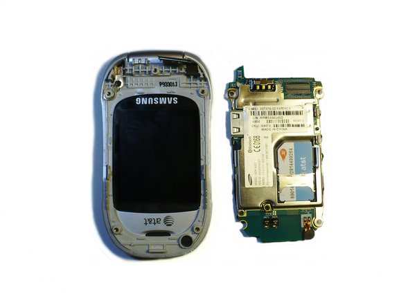

  5. Samsung SGH-A237 Keypad Replacement: crwdns2935265:05crwdnd2935265:01crwdnd2935265:01crwdne2935265:0
    • Detach the tab from the logic board shown by using the Ipod Opening Tool
  6. Samsung SGH-A237 Keypad Replacement: crwdns2935265:06crwdnd2935265:01crwdnd2935265:02crwdne2935265:0 Samsung SGH-A237 Keypad Replacement: crwdns2935265:06crwdnd2935265:02crwdnd2935265:02crwdne2935265:0
    • Use the Ipod Opening Tool to lift the green logic board carefully.
    • Remove the logic board from the device.
  7. Samsung SGH-A237 Keypad Replacement: crwdns2935265:07crwdnd2935265:01crwdnd2935265:01crwdne2935265:0
    • The keypad should peel off the logic board with a gentle pull.
    • Use a clean, soft, cotton cloth to gently remove any debris or liquid that may be located on the pad or logic board interface.
