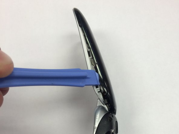

    • Locate the black cover plate on the back side of the viewing screen. It will show the AT&T and Samsung logos.
    • Look on the right side of the phone for the crease in between the black back cover and the front silver cover of the viewing screen.
    • Pry the cover plate off using a plastic opening tool.

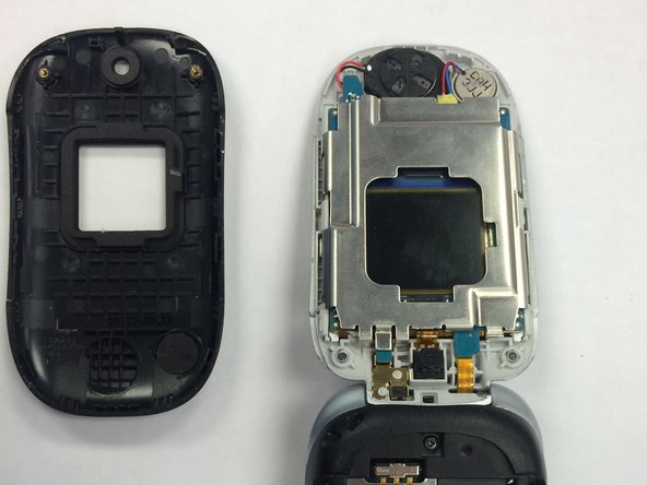

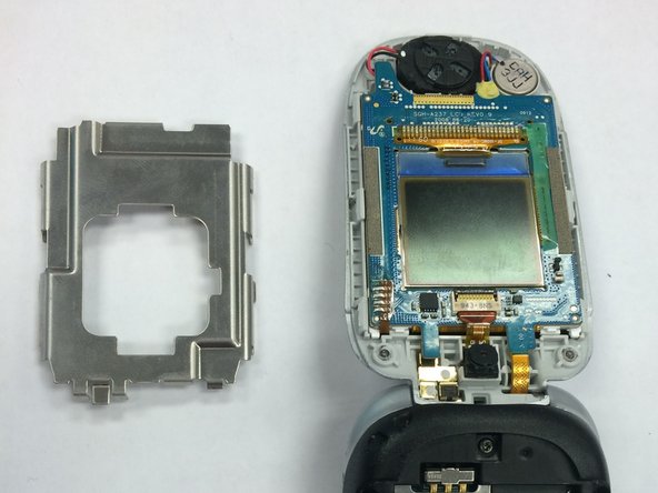

    • Identify the metal bracket that covers the internal body.
    • Identify the metal tabs surrounding the metal bracket mentioned in the previous step.
    • Remove the metal bracket using a small pick or a Phillips #00 screwdriver.
    • Close the phone.

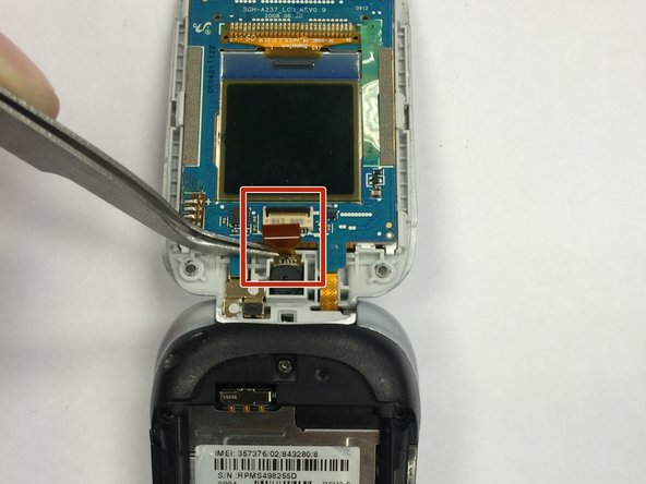

    • Find the camera on the upper part of the phone. It will be displayed as a small black circle.
    • Follow the copper ribbon connected to the camera downward to the black connection port.
  7. Samsung SGH-A237 Camera Replacement: crwdns2935265:07crwdnd2935265:01crwdnd2935265:02crwdne2935265:0 Samsung SGH-A237 Camera Replacement: crwdns2935265:07crwdnd2935265:02crwdnd2935265:02crwdne2935265:0
    • Failure to utilize the specified tool in the proper way may cause damage to the device.
    • Pry up the black connector using a pick. This should lock the black connector into an upward position, which will release the copper ribbon connected to the phone's camera.
  8. Samsung SGH-A237 Camera Replacement: crwdns2935265:08crwdnd2935265:01crwdnd2935265:02crwdne2935265:0 Samsung SGH-A237 Camera Replacement: crwdns2935265:08crwdnd2935265:02crwdnd2935265:02crwdne2935265:0
    • Gently grasp the copper ribbon attached to the camera using a pair of tweezers.
    • Gently pull copper ribbon towards the camera. This should pull the copper ribbon out completely.
