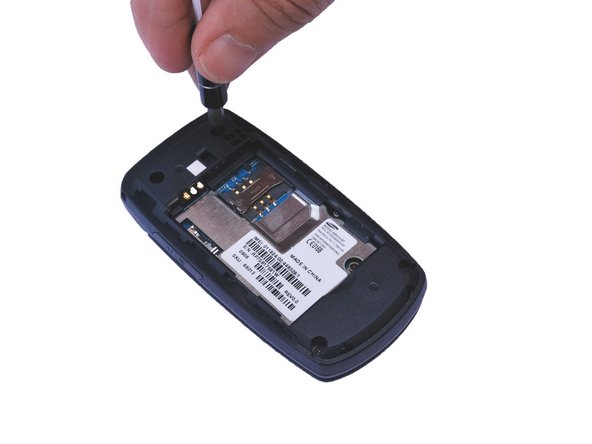

      • Use your thumbs to pull down on the back cover to remove it and expose the battery.
    2. Samsung SGH-A137 Keypad Replacement: crwdns2935265:02crwdnd2935265:01crwdnd2935265:01crwdne2935265:0
      • Locate the indent in the case below the battery. (see red square)
      • Place your finger at the indent and pull up on the battery to remove it.

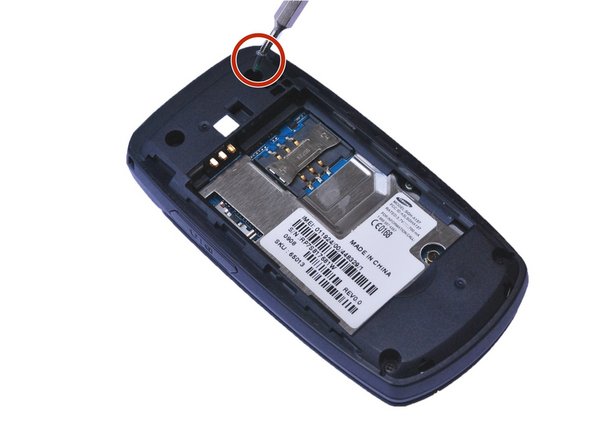

    1. Samsung SGH-A137 Keypad Replacement, Motherboard: crwdns2935265:03crwdnd2935265:01crwdnd2935265:03crwdne2935265:0 Samsung SGH-A137 Keypad Replacement, Motherboard: crwdns2935265:03crwdnd2935265:02crwdnd2935265:03crwdne2935265:0 Samsung SGH-A137 Keypad Replacement, Motherboard: crwdns2935265:03crwdnd2935265:03crwdnd2935265:03crwdne2935265:0
      • Locate the 4 screw holes and remove the 0.4 mm Phillips head screws using a #000 Phillips head screwdriver. (See red circles)

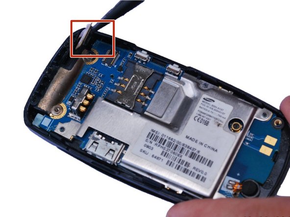

      • Smaller press-fit connectors may require a simple flick with a plastic opening tool or spudger.
      • Place the flat edge of a spudger under the edge of the press-fit connector and , gently pry the connector straight up from its socket. (Highlighted by the red square)
    4. Samsung SGH-A137 Keypad Replacement: crwdns2935265:06crwdnd2935265:01crwdnd2935265:01crwdne2935265:0
      • Using a plastic opening tool, gently pry up the motherboard.
      • You might need to pry from several different locations to get the motherboard loose enough to remove.
