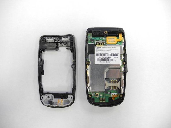

  4. Samsung SGH-A117: Breakdown and Reassembly, Removing the Back Cover: crwdns2935265:04crwdnd2935265:01crwdnd2935265:02crwdne2935265:0 Samsung SGH-A117: Breakdown and Reassembly, Removing the Back Cover: crwdns2935265:04crwdnd2935265:02crwdnd2935265:02crwdne2935265:0
    • Insert the spudger under the back cover at the marked locations and gently lift to remove the back cover.
    • The end of the phone closest to the hinge will require additional force to lift.
    • Be careful not to bend the cover during the removal process.

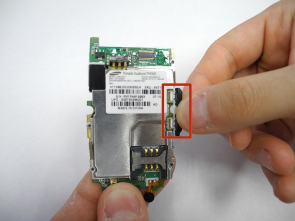

  6. Samsung SGH-A117: Breakdown and Reassembly, Lift Logic Board: crwdns2935265:06crwdnd2935265:01crwdnd2935265:02crwdne2935265:0 Samsung SGH-A117: Breakdown and Reassembly, Lift Logic Board: crwdns2935265:06crwdnd2935265:02crwdnd2935265:02crwdne2935265:0
    • Use a spudger to lift the logic board and separate it from the main body of the phone.
    • It is recommended to lift from the bottom part of the logic board as shown in the picture.
    • Be careful not to lose the volume button, which is loosely attached to the logic board.
