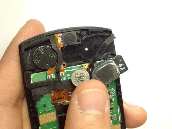

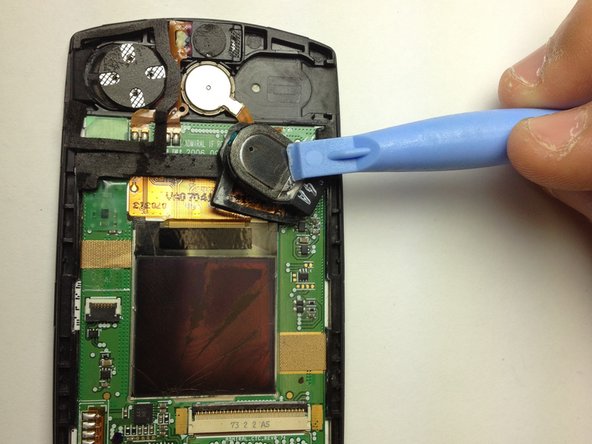

  17. Samsung SGH A707 Speaker Replacement, Speaker: crwdns2935265:017crwdnd2935265:01crwdnd2935265:01crwdne2935265:0
    • Use the prying tool to remove the speaker. They are secured in place by glue, so some force is needed.
    • Be careful not to slip the tool onto your hand as you apply force.
    • Use a soldering iron to disconnect the wires from the speakers (highlighted in the yellow boxes).
    • There's risk of skin burn when using the soldering iron, caution is needed.
    • Avoid breathing in the fumes while soldering.
