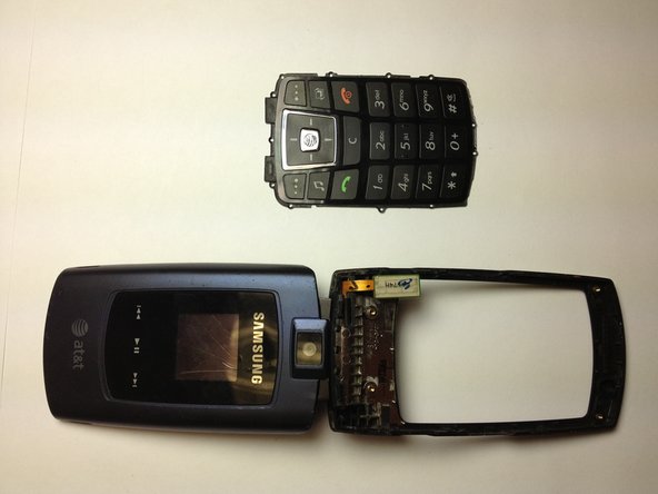

  10. Samsung SGH A707 Keypad Replacement, Keypad: crwdns2935265:010crwdnd2935265:01crwdnd2935265:01crwdne2935265:0
    • Hold the phone and gently separate the circuit board that holds the dome switches and the front face of the phone, revealing the rubber keyboard.
  11. Samsung SGH A707 Keypad Replacement: crwdns2935265:011crwdnd2935265:01crwdnd2935265:01crwdne2935265:0
    • Here is the phone without the dome switch circuit board.
  12. Samsung SGH A707 Keypad Replacement: crwdns2935265:012crwdnd2935265:01crwdnd2935265:02crwdne2935265:0 Samsung SGH A707 Keypad Replacement: crwdns2935265:012crwdnd2935265:02crwdnd2935265:02crwdne2935265:0
    • Here is the phone and the rubber keyboard.
  13. Samsung SGH A707 Keypad Replacement: crwdns2935265:013crwdnd2935265:01crwdnd2935265:01crwdne2935265:0
    • Here is the rubber keyboard and the dome switch circuit board. A quick inspection of these elements can reveal keypad malfunctions. Look for dirt or debris that do not belong there.
