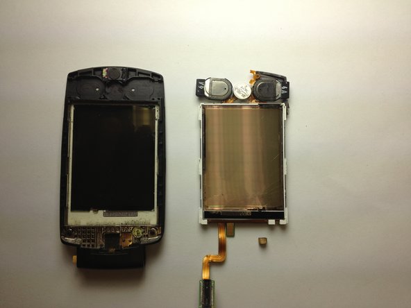

  13. Samsung SGH A707 Display Replacement, Display: crwdns2935265:013crwdnd2935265:01crwdnd2935265:01crwdne2935265:0
    • Separate the two flaps to make handling easier.
    • Use a screw driver to press a latch in along the axis of the hinge and simultaneously pull the pieces apart.
    • Gently pull the flat cable through the hinge.
  14. Samsung SGH A707 Display Replacement: crwdns2935265:014crwdnd2935265:01crwdnd2935265:01crwdne2935265:0
    • Use the prying tool to separate the screen from the rest of the phone.
    • Be careful not to lose the little cube of foam and wire that is under the circuit board. It is important in connecting two different circuits and must be placed back when the phone is reassembled.
  15. Samsung SGH A707 Display Replacement: crwdns2935265:015crwdnd2935265:01crwdnd2935265:02crwdne2935265:0 Samsung SGH A707 Display Replacement: crwdns2935265:015crwdnd2935265:02crwdnd2935265:02crwdne2935265:0
