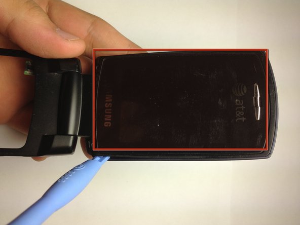

  14. Samsung SGH A707 Camera Replacement, Front Pane: crwdns2935265:014crwdnd2935265:01crwdnd2935265:02crwdne2935265:0 Samsung SGH A707 Camera Replacement, Front Pane: crwdns2935265:014crwdnd2935265:02crwdnd2935265:02crwdne2935265:0
    • Use the Phillips #0 screw driver to remove the two screws.
    • Place the screws in a safe place.
    • Use the prying tool to gently pry the screen off, by slowly moving the prying tool around the entire edge of the screen (roughly highlighted with a red rectangle). You must be very gentle, otherwise the screen will crack.
