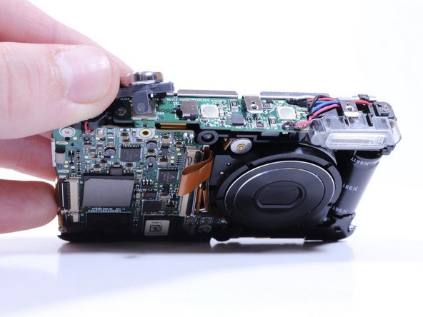

    1. Samsung SCV-VLUUST50 Flash Bulb Replacement, Flash Bulb: crwdns2935265:05crwdnd2935265:01crwdnd2935265:02crwdne2935265:0 Samsung SCV-VLUUST50 Flash Bulb Replacement, Flash Bulb: crwdns2935265:05crwdnd2935265:02crwdnd2935265:02crwdne2935265:0
      • Remove the screw securing the shutter button to the camera frame.
      • Lift the shutter button to remove it.
    2. Samsung SCV-VLUUST50 Flash Bulb Replacement: crwdns2935265:06crwdnd2935265:01crwdnd2935265:02crwdne2935265:0 Samsung SCV-VLUUST50 Flash Bulb Replacement: crwdns2935265:06crwdnd2935265:02crwdnd2935265:02crwdne2935265:0
      • Remove the screws from the circuitry with a Phillips #000 driver.
      • Remove the screw connecting the flash housing to the camera frame with the same driver.
    3. Samsung SCV-VLUUST50 Flash Bulb Replacement: crwdns2935265:07crwdnd2935265:01crwdnd2935265:02crwdne2935265:0 Samsung SCV-VLUUST50 Flash Bulb Replacement: crwdns2935265:07crwdnd2935265:02crwdnd2935265:02crwdne2935265:0
      • Pull the flash housing away from the camera frame.
      • Cut the wires connecting the flash module to the circuitry.
      • Connect the new flash module to the circuitry with a soldering iron and electrical solder.
