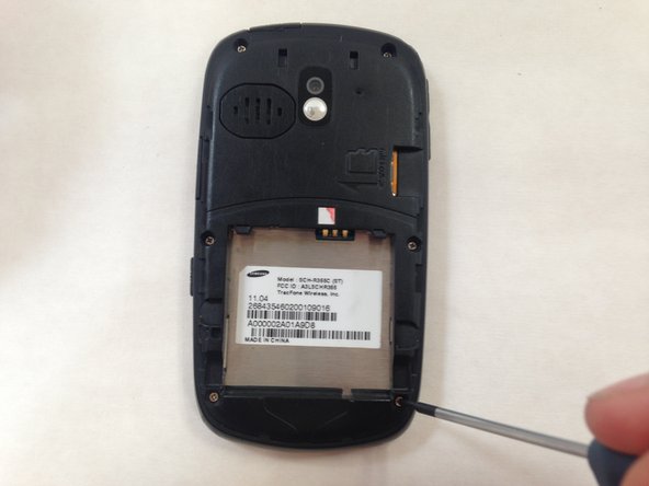

      • Remove the battery from the phone.
    3. Samsung SCH-R355C Keyboard Replacement: crwdns2935265:03crwdnd2935265:01crwdnd2935265:02crwdne2935265:0 Samsung SCH-R355C Keyboard Replacement: crwdns2935265:03crwdnd2935265:02crwdnd2935265:02crwdne2935265:0
      • Use a small #00 Phillips-head screwdriver to unscrew all 6 of the 4 mm back screws.
    4. Samsung SCH-R355C Keyboard Replacement: crwdns2935265:04crwdnd2935265:01crwdnd2935265:01crwdne2935265:0
      • Push down on the silver part of the phone where the battery used to be located. Hold the back of the case to catch it as it comes off.

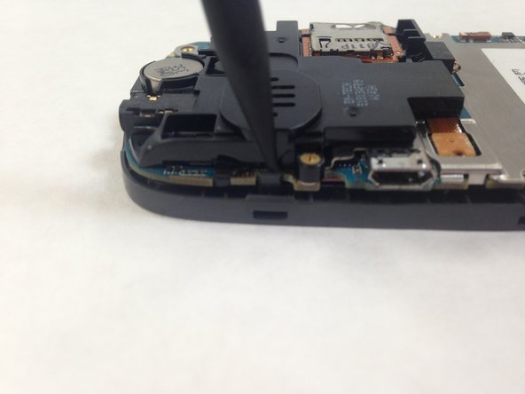

    5. Samsung SCH-R355C Keyboard Replacement: crwdns2935265:05crwdnd2935265:01crwdnd2935265:02crwdne2935265:0 Samsung SCH-R355C Keyboard Replacement: crwdns2935265:05crwdnd2935265:02crwdnd2935265:02crwdne2935265:0
      • Pry away the friction holder on the top left-hand side of the motherboard. This will release the motherboard.
      • Don't rip the cord attaching the motherboard to the case when you lift the motherboard up. This will render the phone unusable.

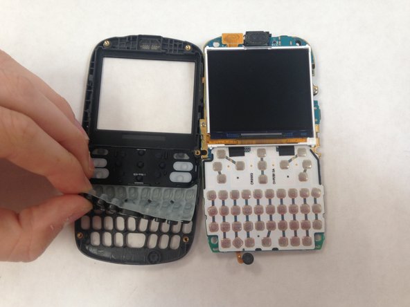

    6. Samsung SCH-R355C Keyboard Replacement: crwdns2935265:06crwdnd2935265:01crwdnd2935265:02crwdne2935265:0 Samsung SCH-R355C Keyboard Replacement: crwdns2935265:06crwdnd2935265:02crwdnd2935265:02crwdne2935265:0
      • Lift the keyboard membrane from the bottom and replace it.
