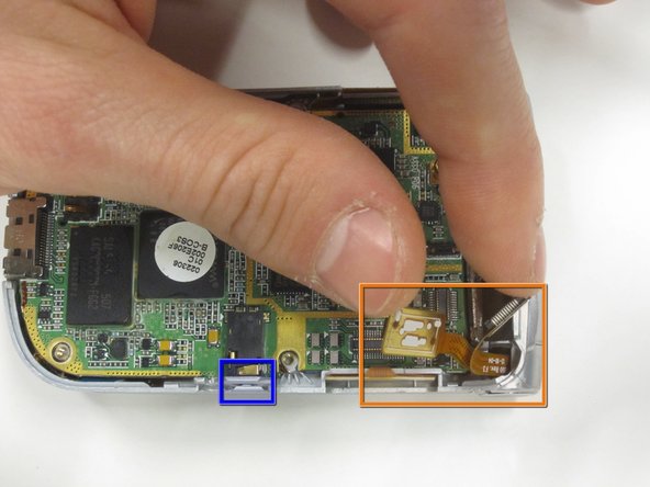

    • Gently unplug the external speaker wire from the logic board. After the wire is unplugged the back cover should come off easily.

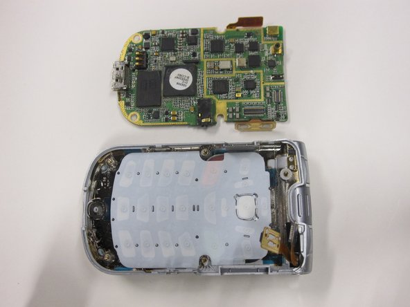

  5. Samsung SCH-A890 Logic Board Replacement, Logic Board: crwdns2935265:05crwdnd2935265:01crwdnd2935265:03crwdne2935265:0 Samsung SCH-A890 Logic Board Replacement, Logic Board: crwdns2935265:05crwdnd2935265:02crwdnd2935265:03crwdne2935265:0 Samsung SCH-A890 Logic Board Replacement, Logic Board: crwdns2935265:05crwdnd2935265:03crwdnd2935265:03crwdne2935265:0
    • To disconnect the logic board from the main body, unplug the gold ribbon from its outlet.
    • The logic board fits to the casing by the headphone jack. Simply slide it out of place and remove it from the device.
