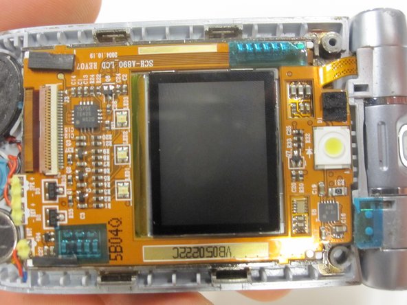

    • Open the device so that the inside of the phone is facing you.
    • Remove the small, gray, circular covers on the bottom left and right corners of the inside face of the phone.
  2. Samsung SCH-A890 Front Screen Replacement: crwdns2935265:02crwdnd2935265:01crwdnd2935265:01crwdne2935265:0
    • Use the size 00 screwdriver to remove the two small screws underneath the removed covers.
    • The screws are slightly magnetic and will want to stay in place. May have to follow the next step and get the cover off, then poke the screws out.
  3. Samsung SCH-A890 Front Screen Replacement: crwdns2935265:03crwdnd2935265:01crwdnd2935265:02crwdne2935265:0 Samsung SCH-A890 Front Screen Replacement: crwdns2935265:03crwdnd2935265:02crwdnd2935265:02crwdne2935265:0

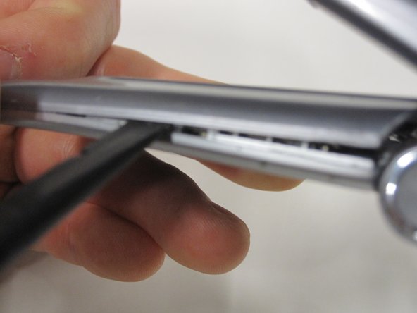

    • Insert the spudger between the top and bottom plates to pry the cover off.
    • You may need to gently slide the spudger up and down to loosen the cover without snapping it.
    • Alternate between sides to loosen the cover more safely and effectively.
  4. Samsung SCH-A890 Front Screen Replacement: crwdns2935265:04crwdnd2935265:01crwdnd2935265:02crwdne2935265:0 Samsung SCH-A890 Front Screen Replacement: crwdns2935265:04crwdnd2935265:02crwdnd2935265:02crwdne2935265:0
    • Carefully remove the cover off the device without scratching the display or harming the components.
    • Work in a dry, dust-free environment to prevent liquid or dust particles from entering the components.
