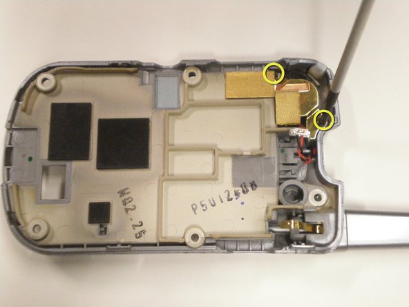

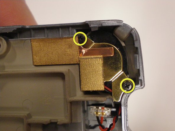

  5. Samsung SCH-A890 External Speaker Replacement, External Speaker: crwdns2935265:05crwdnd2935265:01crwdnd2935265:03crwdne2935265:0 Samsung SCH-A890 External Speaker Replacement, External Speaker: crwdns2935265:05crwdnd2935265:02crwdnd2935265:03crwdne2935265:0 Samsung SCH-A890 External Speaker Replacement, External Speaker: crwdns2935265:05crwdnd2935265:03crwdnd2935265:03crwdne2935265:0
    • Remove both screws with a #00 philips screwdriver.
  6. Samsung SCH-A890 External Speaker Replacement: crwdns2935265:06crwdnd2935265:01crwdnd2935265:03crwdne2935265:0 Samsung SCH-A890 External Speaker Replacement: crwdns2935265:06crwdnd2935265:02crwdnd2935265:03crwdne2935265:0 Samsung SCH-A890 External Speaker Replacement: crwdns2935265:06crwdnd2935265:03crwdnd2935265:03crwdne2935265:0

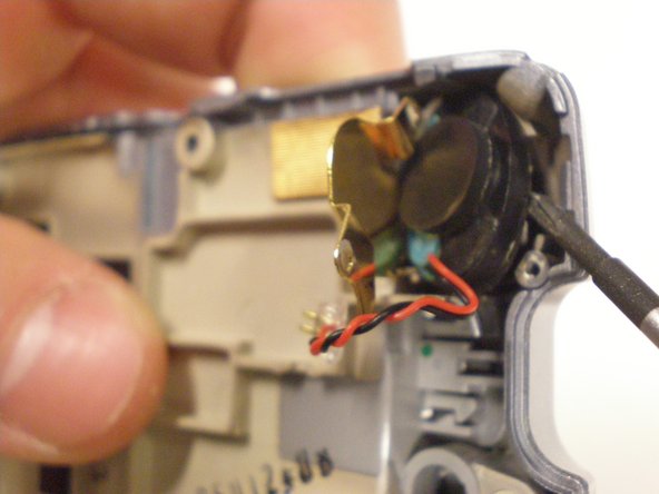

    • Once the screws are removed gently pull back the gold mount to expose the speaker.

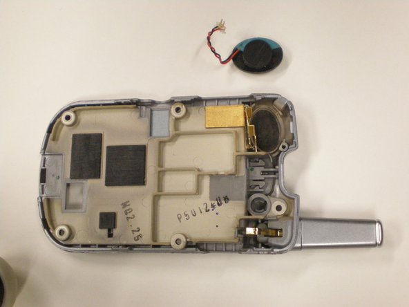

    • Remove the small piece of plastic that holds the wire down.
    • Use your fingernail or a small screw driver to pry the speaker out.
