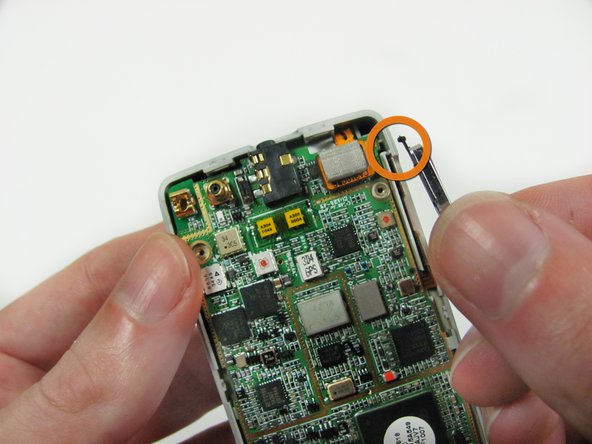

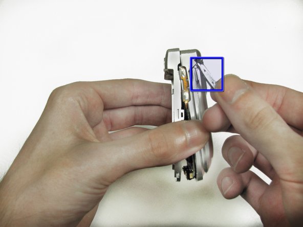

      • Use the wide plastic prying tool to open the back case.
      • To make this process easier, use the tool to push against this tab while gently pulling the back upward.
      • Repeat this process on the opposite side.
      • The volume button may fall out, but don't force it back in. Set it aside for reassembly.
      • When replacing the volume button, the rubber tab must be placed carefully into the space in the inner casing.

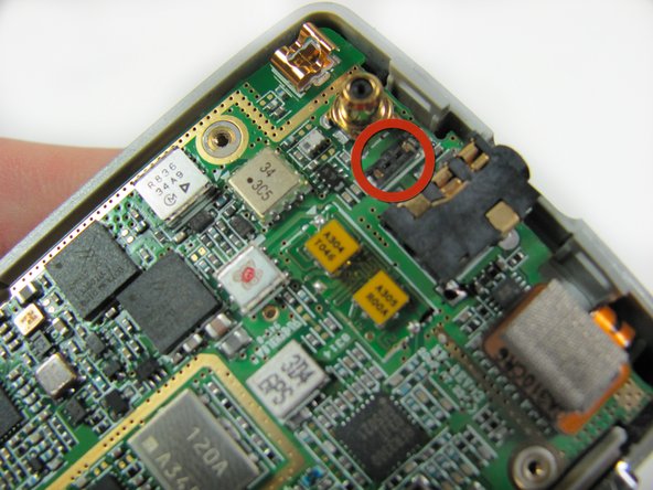

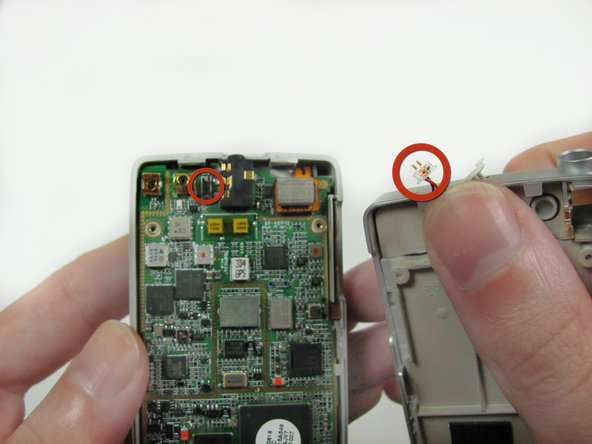

    3. Samsung SCH-A310 Keypad Replacement: crwdns2935265:05crwdnd2935265:01crwdnd2935265:03crwdne2935265:0 Samsung SCH-A310 Keypad Replacement: crwdns2935265:05crwdnd2935265:02crwdnd2935265:03crwdne2935265:0 Samsung SCH-A310 Keypad Replacement: crwdns2935265:05crwdnd2935265:03crwdnd2935265:03crwdne2935265:0
      • Pull the back plate up by gently twisting slightly towards the top left corner. When you feel the catch release, you can fold the plate back like a book cover.
      • Be careful of the connectors. There are two very small wires which run to the back cover of the phone.
      • If you accidentally pull the wires out, don't panic. The connector can be pushed back into place very easily.
      • If you are confident in your ability to reassemble the device, pulling the connector out can make this process easier by getting the back casing out of the way.

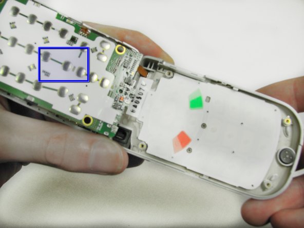

    4. Samsung SCH-A310 Keypad Replacement: crwdns2935265:06crwdnd2935265:01crwdnd2935265:02crwdne2935265:0 Samsung SCH-A310 Keypad Replacement: crwdns2935265:06crwdnd2935265:02crwdnd2935265:02crwdne2935265:0
      • Fold the circuit board back like a book cover just as you did with the back plate.
      • Be careful of this connector which goes to the front of the phone.
      • Unlike the connector in the previous step, this one should not be removed unless you plan to replace the motherboard.
      • The silver contacts on the bottom of the motherboard are what recognize key presses; if the phone isn't responding to key presses, you will need to replace the motherboard here.
