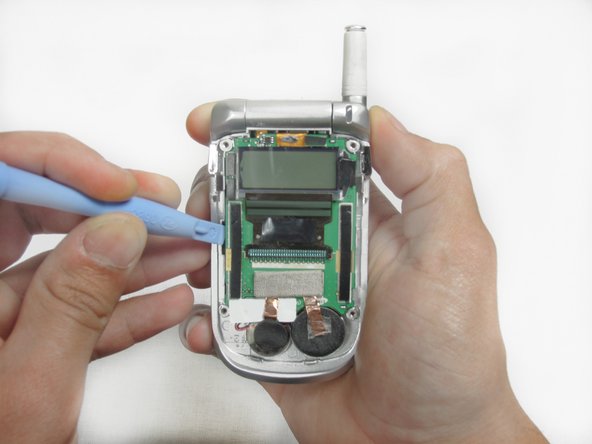

      • Locate the tabs on either side of the phone. Pull the outer case away from each tab with the plastic opening tool.
    4. Samsung SCH-A310 Inside Screen Replacement: crwdns2935265:04crwdnd2935265:01crwdnd2935265:03crwdne2935265:0 Samsung SCH-A310 Inside Screen Replacement: crwdns2935265:04crwdnd2935265:02crwdnd2935265:03crwdne2935265:0 Samsung SCH-A310 Inside Screen Replacement: crwdns2935265:04crwdnd2935265:03crwdnd2935265:03crwdne2935265:0
      • Hold the phone upside-down.
      • Two plastic tabs are located under the lip of your phone. Use a plastic opening tool to pop the outer case away from the tabs.
      • After the outside case is clear of the four tabs, removed it.

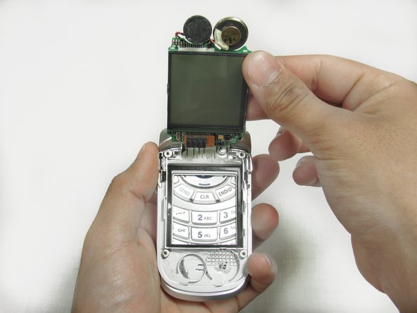

    1. Samsung SCH-A310 Inside Screen Replacement, Inside Screen: crwdns2935265:05crwdnd2935265:01crwdnd2935265:03crwdne2935265:0 Samsung SCH-A310 Inside Screen Replacement, Inside Screen: crwdns2935265:05crwdnd2935265:02crwdnd2935265:03crwdne2935265:0 Samsung SCH-A310 Inside Screen Replacement, Inside Screen: crwdns2935265:05crwdnd2935265:03crwdnd2935265:03crwdne2935265:0
      • Pry the speakers from the casing, which are attached with only glue.
      • Pry the board (entire insides) from the casing using the pry tool.
      • The screen should be able to lift almost completely away as shown.

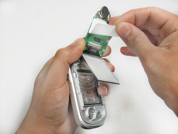

    2. Samsung SCH-A310 Inside Screen Replacement: crwdns2935265:06crwdnd2935265:01crwdnd2935265:03crwdne2935265:0 Samsung SCH-A310 Inside Screen Replacement: crwdns2935265:06crwdnd2935265:02crwdnd2935265:03crwdne2935265:0 Samsung SCH-A310 Inside Screen Replacement: crwdns2935265:06crwdnd2935265:03crwdnd2935265:03crwdne2935265:0
      • Peel the screen from the rest of the board using your fingers. Be careful not to break anything.
      • Lastly, peel the white paper up and away from the screen to reveal the screen's electrical connection.
      • Remove the screen's electrical tab, disconnecting the entire screen from the phone.
