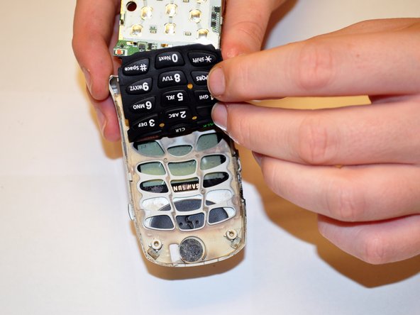

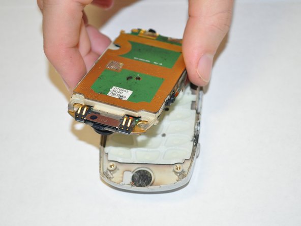

    1. Samsung SCH-8500 Keypad Replacement, Keypad: crwdns2935265:04crwdnd2935265:01crwdnd2935265:03crwdne2935265:0 Samsung SCH-8500 Keypad Replacement, Keypad: crwdns2935265:04crwdnd2935265:02crwdnd2935265:03crwdne2935265:0 Samsung SCH-8500 Keypad Replacement, Keypad: crwdns2935265:04crwdnd2935265:03crwdnd2935265:03crwdne2935265:0
      • The circuit board is hardwired to other components in the phone and cannot be completely removed. Take extreme precaution when performing this step as to not damage the circuitry or the wiring.
      • Lift the circuit board up slightly.
      • With the circuit board lifted, remove the plastic keypad and place to the side.
