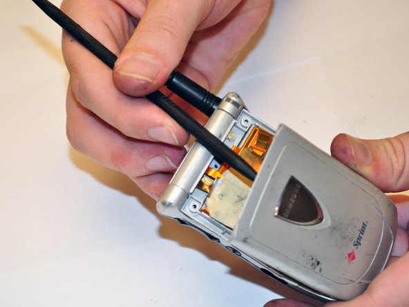

    • Use a Philips #0 screwdriver to remove the two screws below the screen.
  2. Samsung SCH-8500 Front Cover Replacement: crwdns2935265:02crwdnd2935265:01crwdnd2935265:03crwdne2935265:0 Samsung SCH-8500 Front Cover Replacement: crwdns2935265:02crwdnd2935265:02crwdnd2935265:03crwdne2935265:0 Samsung SCH-8500 Front Cover Replacement: crwdns2935265:02crwdnd2935265:03crwdnd2935265:03crwdne2935265:0
    • Using the spudger, separate the black speaker cover from the top part of the phone.
    • Gently remove the black speaker cover completely.
    • Remove the two screws, approximately 10 mm in length, behind the black speaker cover with the screwdriver.
  3. Samsung SCH-8500 Front Cover Replacement: crwdns2935265:03crwdnd2935265:01crwdnd2935265:02crwdne2935265:0 Samsung SCH-8500 Front Cover Replacement: crwdns2935265:03crwdnd2935265:02crwdnd2935265:02crwdne2935265:0
    • Once the two screws are taken out, use the spudger to remove the front cover of the phone.
