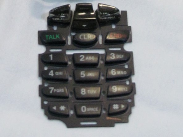

    1. Samsung SCH-3500 Key Pad Replacement, Key Pad: crwdns2935265:014crwdnd2935265:01crwdnd2935265:02crwdne2935265:0 Samsung SCH-3500 Key Pad Replacement, Key Pad: crwdns2935265:014crwdnd2935265:02crwdnd2935265:02crwdne2935265:0
      • Turn the front cover over and shake the keys out of it. They should come free in a single piece.
      • Note: The keypad may accidentally come free while removing rear cover or logic board. It is best to remove the logic board to reinstall the key mat.
      • The key pad is now removed from the phone. Congratulations.
