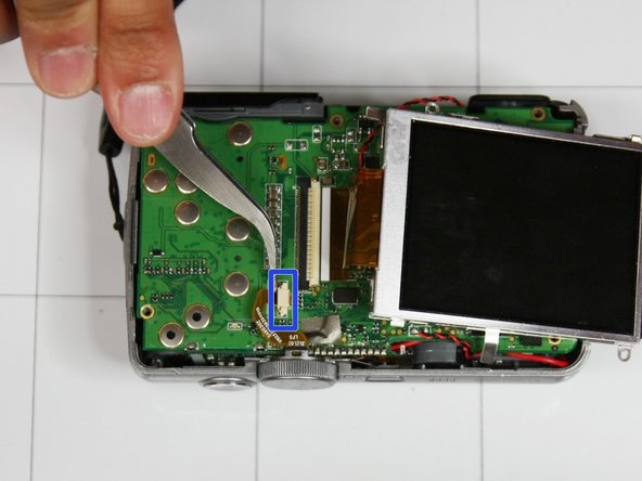

  4. Samsung S85 Rubber Door Replacement: crwdns2935265:04crwdnd2935265:01crwdnd2935265:02crwdne2935265:0 Samsung S85 Rubber Door Replacement: crwdns2935265:04crwdnd2935265:02crwdnd2935265:02crwdne2935265:0
    • Gently remove orange circuit ribbon identified by red square
    • Gently remove narrow orange circuit ribbon identified by blue square
