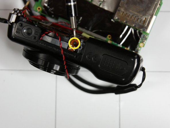

    9. Samsung S85 Lens Replacement: crwdns2935265:09crwdnd2935265:01crwdnd2935265:03crwdne2935265:0 Samsung S85 Lens Replacement: crwdns2935265:09crwdnd2935265:02crwdnd2935265:03crwdne2935265:0 Samsung S85 Lens Replacement: crwdns2935265:09crwdnd2935265:03crwdnd2935265:03crwdne2935265:0
      • Remove three interior screws as noted in the first picture.
      • Remove screwed attached to orange circuit ribbon as shown in second picture.
      • Remove third screw attached to orange circuit ribbon as shown in third picture.

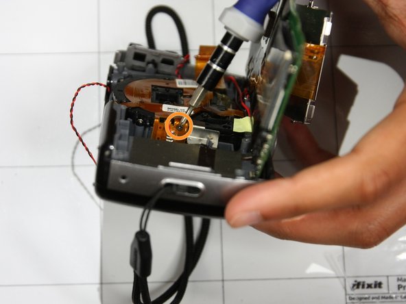

    10. Samsung S85 Lens Replacement: crwdns2935265:010crwdnd2935265:01crwdnd2935265:03crwdne2935265:0 Samsung S85 Lens Replacement: crwdns2935265:010crwdnd2935265:02crwdnd2935265:03crwdne2935265:0 Samsung S85 Lens Replacement: crwdns2935265:010crwdnd2935265:03crwdnd2935265:03crwdne2935265:0
      • Using screwdriver, remove silver metal piece located in center of camera.
      • Using tweezers, gently remove orange circuit from lens. This step is tricky as the orange circuit is very securely placed in the lens.
      • After the removal of the silver piece and orange circuit remove black circle from center of camera. This is the lens
      • Gently remove top portion of lens as shown in the third picture.

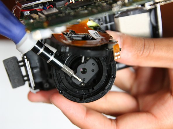

    11. Samsung S85 Lens Replacement: crwdns2935265:011crwdnd2935265:01crwdnd2935265:02crwdne2935265:0 Samsung S85 Lens Replacement: crwdns2935265:011crwdnd2935265:02crwdnd2935265:02crwdne2935265:0
      • Remove two screws attached to internal part of lens using screwdriver
      • Using tweezers to remove thin black layer to reveal lens.
