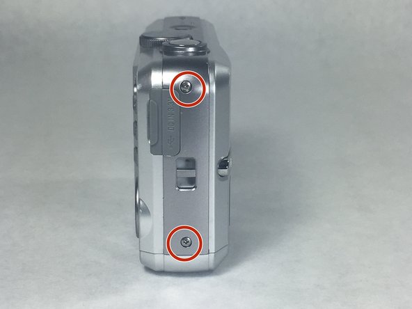

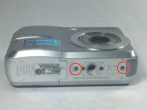

    • All screws in this camera are removed using the Phillip Screwdriver #000 bit. Also, all dimensions included refer to screw lengths.
    • Locate and remove the six 4mm screws on the sides of the camera.

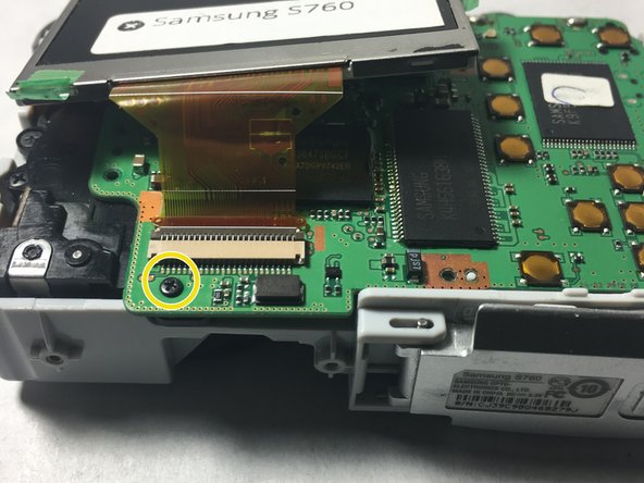

    • Move the screen down, out of the way to remove the two 3mm screws beneath it.
  7. Samsung S760 Camera Lens Replacement Guide: crwdns2935265:07crwdnd2935265:01crwdnd2935265:02crwdne2935265:0 Samsung S760 Camera Lens Replacement Guide: crwdns2935265:07crwdnd2935265:02crwdnd2935265:02crwdne2935265:0
    • Remove the 6mm screw labeled in the picture.
    • Remove the three 3mm screws.
    • Then proceed to flip the screen to the other side to remove the other 6mm screw.
