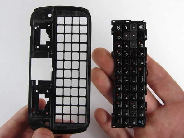

    1. Samsung Rogue Keyboard Replacement, Keyboard: crwdns2935265:09crwdnd2935265:01crwdnd2935265:01crwdne2935265:0
      • Remove the eight 1.7mm Philips screws above the keyboard.
    2. Samsung Rogue Keyboard Replacement: crwdns2935265:010crwdnd2935265:01crwdnd2935265:01crwdne2935265:0
      • Carefully remove keyboard holder from the slider mechanisms underneath.
    3. Samsung Rogue Keyboard Replacement: crwdns2935265:011crwdnd2935265:01crwdnd2935265:02crwdne2935265:0 Samsung Rogue Keyboard Replacement: crwdns2935265:011crwdnd2935265:02crwdnd2935265:02crwdne2935265:0
      • Turn keyboard holder over and allow the keyboard to simply fall out into your hand.
