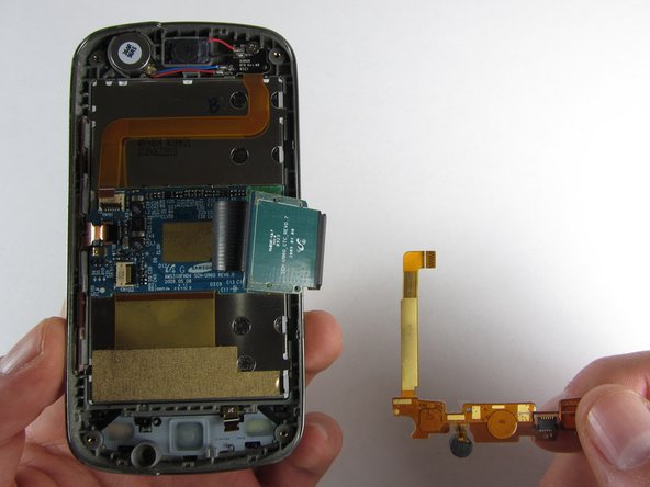

      • Use a plastic opening tool to disconnect the film from the motherboard.

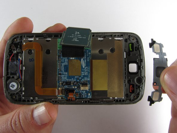

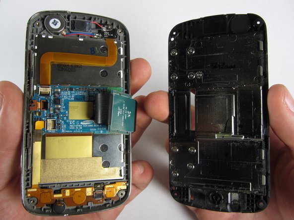

    4. Samsung Rogue Front Function Keys Replacement: crwdns2935265:012crwdnd2935265:01crwdnd2935265:03crwdne2935265:0 Samsung Rogue Front Function Keys Replacement: crwdns2935265:012crwdnd2935265:02crwdnd2935265:03crwdne2935265:0 Samsung Rogue Front Function Keys Replacement: crwdns2935265:012crwdnd2935265:03crwdnd2935265:03crwdne2935265:0

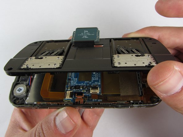

      • Use a plastic opening tool to pry off the upper slide plate.
      • Be careful of the film of wires when taking off the upper slide plate.

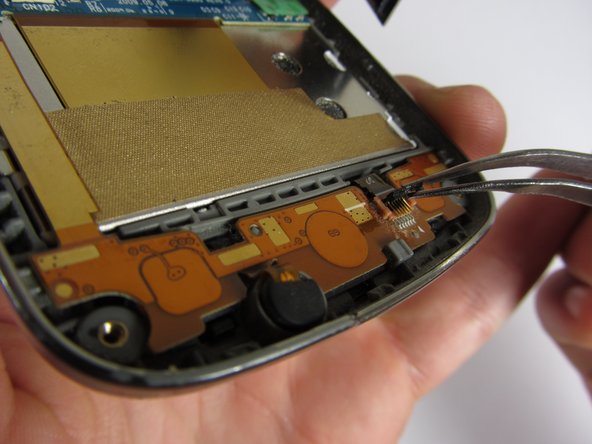

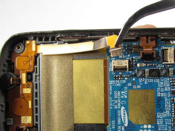

      • Use tweezers to open the two black gates by putting them in the "up" position.
      • With the same tweezers, carefully pull out the orange strips from the two specified gates.
    6. Samsung Rogue Front Function Keys Replacement: crwdns2935265:014crwdnd2935265:01crwdnd2935265:03crwdne2935265:0 Samsung Rogue Front Function Keys Replacement: crwdns2935265:014crwdnd2935265:02crwdnd2935265:03crwdne2935265:0 Samsung Rogue Front Function Keys Replacement: crwdns2935265:014crwdnd2935265:03crwdnd2935265:03crwdne2935265:0
      • Using tweezers, gently remove the bottom orange strip from the device.
      • At this point you can easily lift out the rubber function key pad as well.

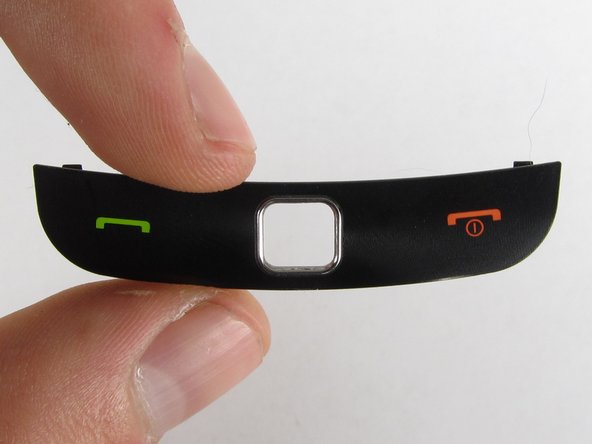

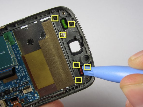

      • There are two ways you can take out the front function keys:
      • 1) Use a plastic phone opening tool to pry out the piece from the front of the phone.
      • 2) Simply pop out the piece from the inside by pushing on its tabs.
