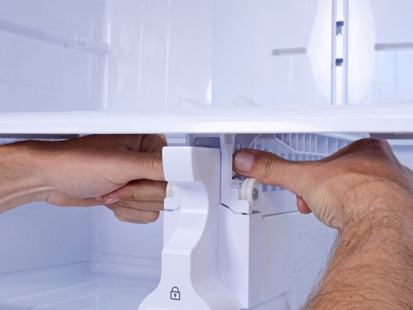

  1. Samsung Refrigerator Fridge Shelf Removal Prereq, Remove the shelves: crwdns2935265:01crwdnd2935265:01crwdnd2935265:02crwdne2935265:0 Samsung Refrigerator Fridge Shelf Removal Prereq, Remove the shelves: crwdns2935265:01crwdnd2935265:02crwdnd2935265:02crwdne2935265:0
    • Remove all the loose shelves and bins from the refrigerator compartment.
    • The bottom shelf is clipped in place. Follow the next step to remove it.
  2. Samsung Refrigerator Fridge Shelf Removal Prereq: crwdns2935265:02crwdnd2935265:01crwdnd2935265:03crwdne2935265:0 Samsung Refrigerator Fridge Shelf Removal Prereq: crwdns2935265:02crwdnd2935265:02crwdnd2935265:03crwdne2935265:0 Samsung Refrigerator Fridge Shelf Removal Prereq: crwdns2935265:02crwdnd2935265:03crwdnd2935265:03crwdne2935265:0
    • Two stiff plastic tabs (one on each side) secure the bottom shelf in place.
    • Press both plastic tabs firmly with your fingers and lift upward to unclip the bottom shelf.
    • If the shelf doesn't unclip, you can try using a flathead screwdriver to press each clip in.
    • Remove the bottom shelf.
