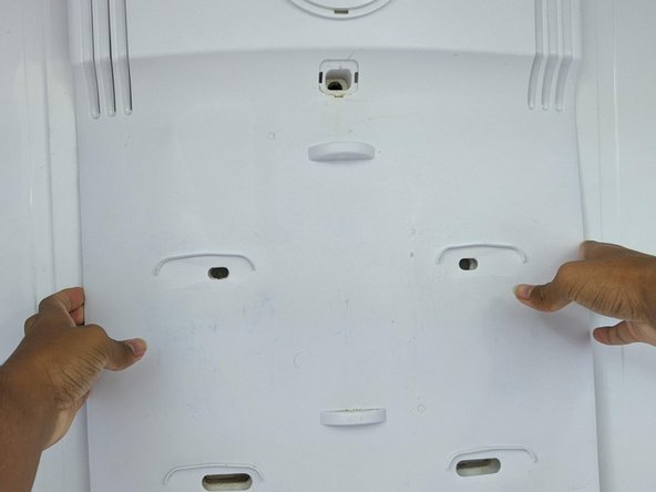

    • Use your hands or a spudger to pry back the plastic cover starting from the bottom.
    • Once all the clips are pulled out, loosen the cover by pushing it slightly up and out.

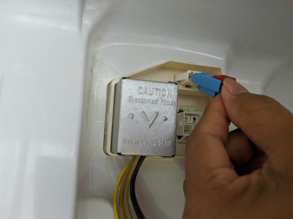

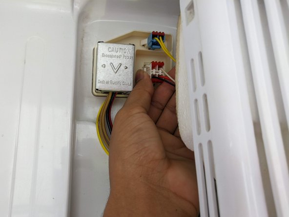

    • Gently unplug both connectors.
    • Remember their orientations as it will be important during reassembly.
