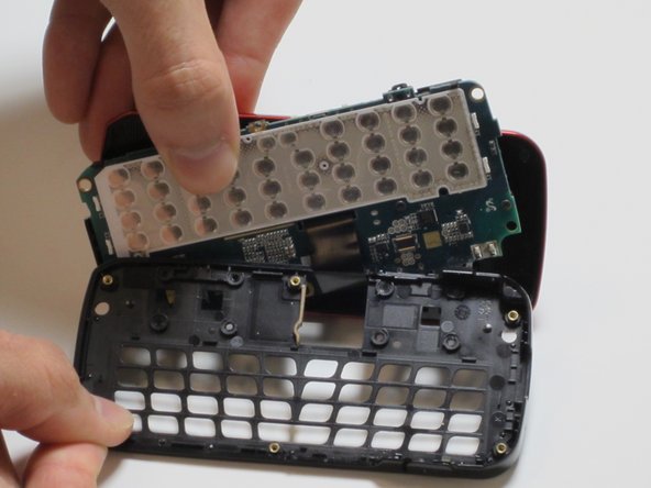

  3. Samsung Rant Keypad Replacement, Rear Case: crwdns2935265:03crwdnd2935265:01crwdnd2935265:01crwdne2935265:0
    • Use a Phillips #00 screwdriver to loosen and remove all 3 screws.
  4. Samsung Rant Keypad Replacement: crwdns2935265:04crwdnd2935265:01crwdnd2935265:01crwdne2935265:0
    • Gently separate the rear case from the front case.
  5. Samsung Rant Keypad Replacement, Keypad: crwdns2935265:05crwdnd2935265:01crwdnd2935265:02crwdne2935265:0 Samsung Rant Keypad Replacement, Keypad: crwdns2935265:05crwdnd2935265:02crwdnd2935265:02crwdne2935265:0
    • Using a pair of tweezers, grip the keypad gently.
    • Lift the keypad out of the phone and replace it (if necessary).
