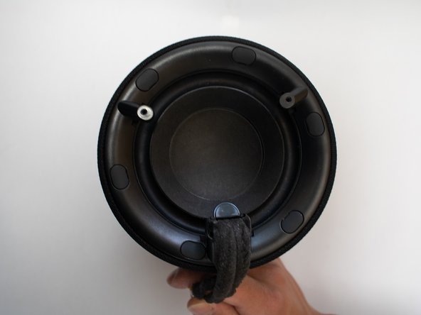

    • Flip the device so that the bottom of the device is facing you. Remove these feet with a pair of tweezers.
    • Remove the four 10mm long screws with the Phillips #1 screwdriver.

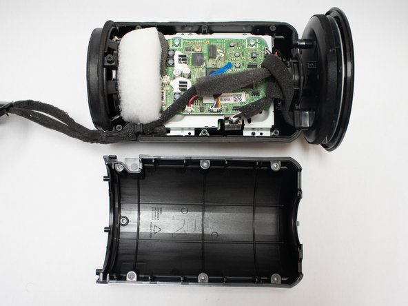

  2. Samsung Radiant360 R3 Tweeter Replacement: crwdns2935265:02crwdnd2935265:01crwdnd2935265:01crwdne2935265:0
    • Remove the bottom shell from the speaker.

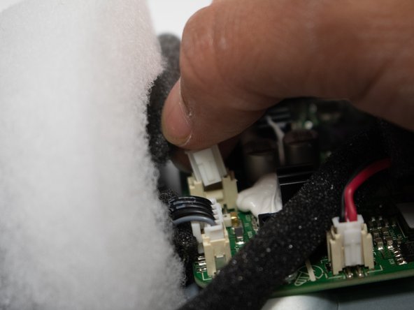

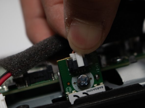

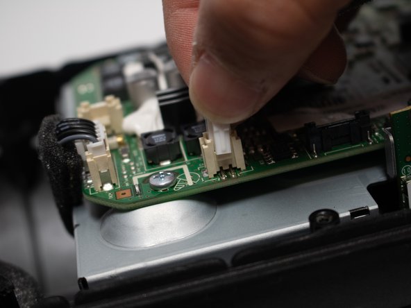

  3. Samsung Radiant360 R3 Tweeter Replacement: crwdns2935265:03crwdnd2935265:01crwdnd2935265:02crwdne2935265:0 Samsung Radiant360 R3 Tweeter Replacement: crwdns2935265:03crwdnd2935265:02crwdnd2935265:02crwdne2935265:0
    • Remove the connector from the board by pressing down on the center tab while nudging the connector away with a spudger.
    • Be careful not to pull directly on the wires or apply too much pressure, or you risk breaking the connector.

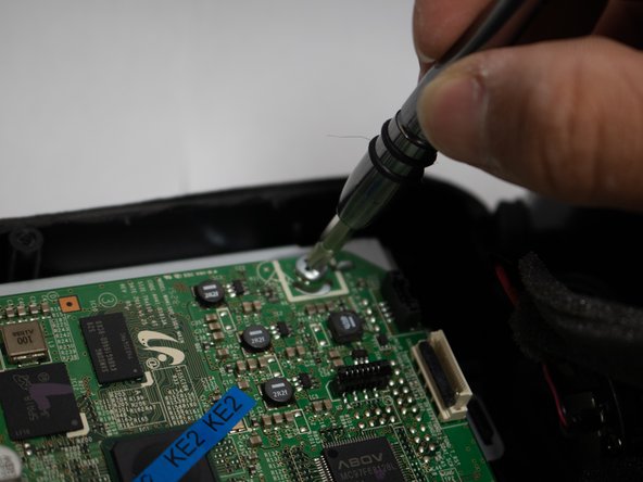

  4. Samsung Radiant360 R3 Tweeter Replacement: crwdns2935265:04crwdnd2935265:01crwdnd2935265:01crwdne2935265:0
    • Remove the two 10mm long screws from the board utilizing the Phillips #1 screwdriver.

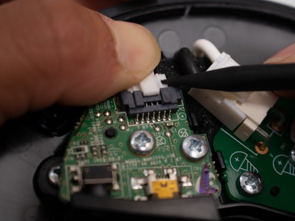

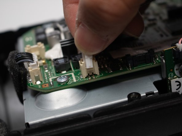

  5. Samsung Radiant360 R3 Tweeter Replacement: crwdns2935265:05crwdnd2935265:01crwdnd2935265:01crwdne2935265:0
    • Use a spudger to press the plastic tab away from the board until the board pops up.
    • Remove the board with the USB module from the device.

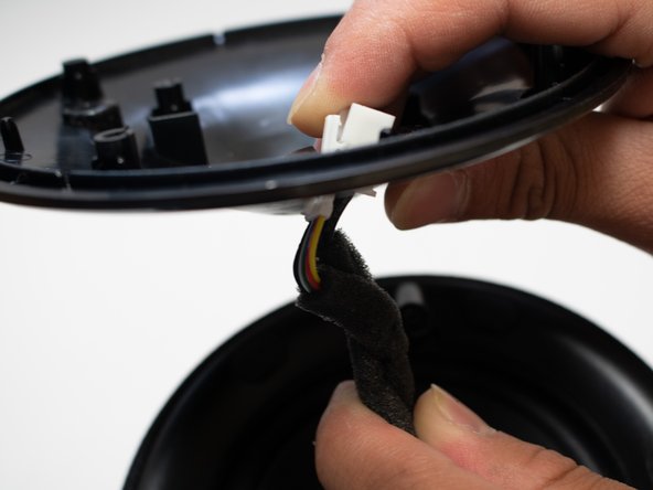

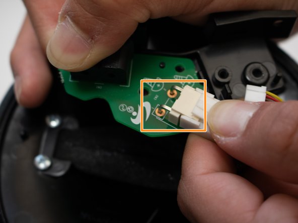

  6. Samsung Radiant360 R3 Tweeter Replacement, Wireless Module: crwdns2935265:06crwdnd2935265:01crwdnd2935265:02crwdne2935265:0 Samsung Radiant360 R3 Tweeter Replacement, Wireless Module: crwdns2935265:06crwdnd2935265:02crwdnd2935265:02crwdne2935265:0
    • Remove the two 12mm long screws with the Phillips #1 screwdriver.
    • Unplug white plug connected to the green circuit board.

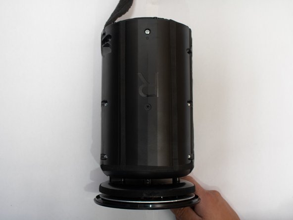

  8. Samsung Radiant360 R3 Tweeter Replacement: crwdns2935265:08crwdnd2935265:01crwdnd2935265:03crwdne2935265:0 Samsung Radiant360 R3 Tweeter Replacement: crwdns2935265:08crwdnd2935265:02crwdnd2935265:03crwdne2935265:0 Samsung Radiant360 R3 Tweeter Replacement: crwdns2935265:08crwdnd2935265:03crwdnd2935265:03crwdne2935265:0
    • Remove rubber covers covering the screws with pair of tweezers.
    • Remove the six 12mm screws that are under the rubber covers with the Phillips #1 screwdriver.

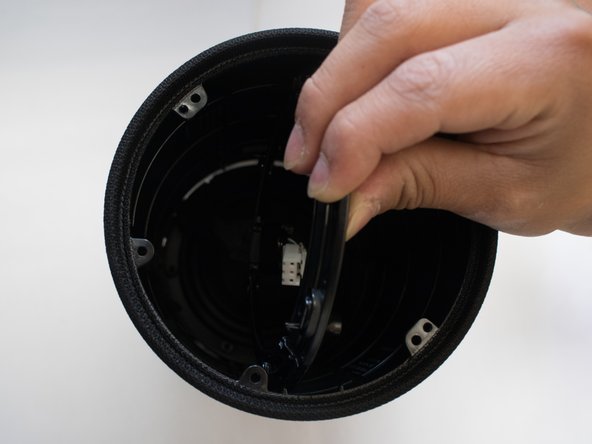

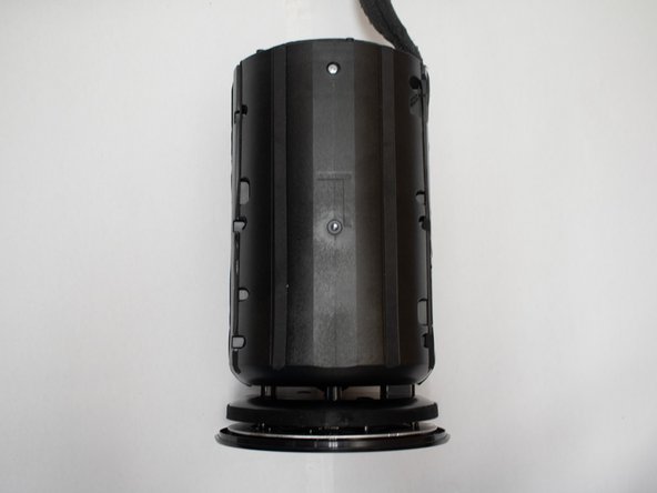

  9. Samsung Radiant360 R3 Tweeter Replacement: crwdns2935265:09crwdnd2935265:01crwdnd2935265:01crwdne2935265:0
    • Remove the unscrewed cover as much as possible.
    • It is very difficult to get plugs at the end of the cord through the cover without breaking, so just slide to the edge.

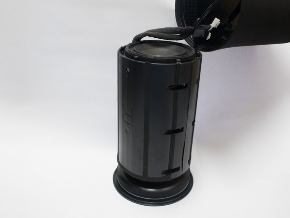

  10. Samsung Radiant360 R3 Tweeter Replacement: crwdns2935265:010crwdnd2935265:01crwdnd2935265:03crwdne2935265:0 Samsung Radiant360 R3 Tweeter Replacement: crwdns2935265:010crwdnd2935265:02crwdnd2935265:03crwdne2935265:0 Samsung Radiant360 R3 Tweeter Replacement: crwdns2935265:010crwdnd2935265:03crwdnd2935265:03crwdne2935265:0
    • Push the body out through the outer shell of device.
    • Carefully push the ring attached to the cable through the shell.

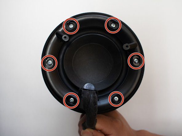

  21. Samsung Radiant360 R3 Tweeter Replacement, Tweeter: crwdns2935265:021crwdnd2935265:01crwdnd2935265:01crwdne2935265:0
    • Remove the six 8mm screws using the Phillips #1 screwdriver.
    • Remove the six 12mm screws using the Phillips #1 screwdriver.
