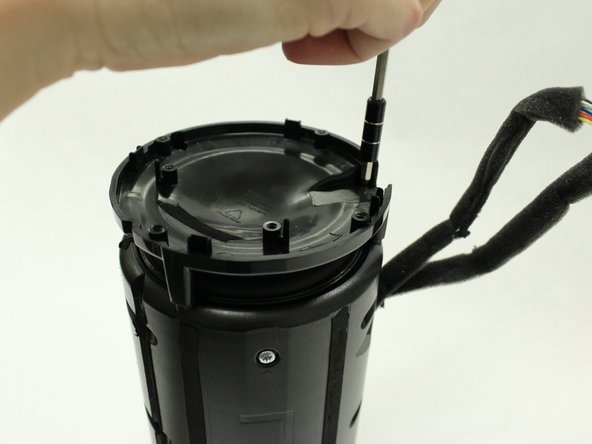

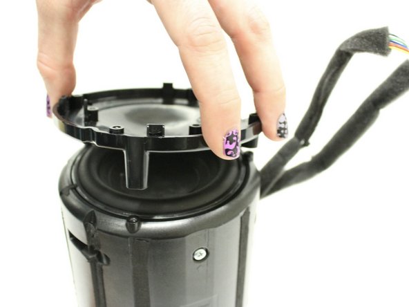

    • Using a PH1 Philips screwdriver, remove four (9.5mm x 1.6mm) screws from the base plate.
    • Remove base plate by stabilizing speaker and using plastic prying tool to pry the base plate from the speaker.
