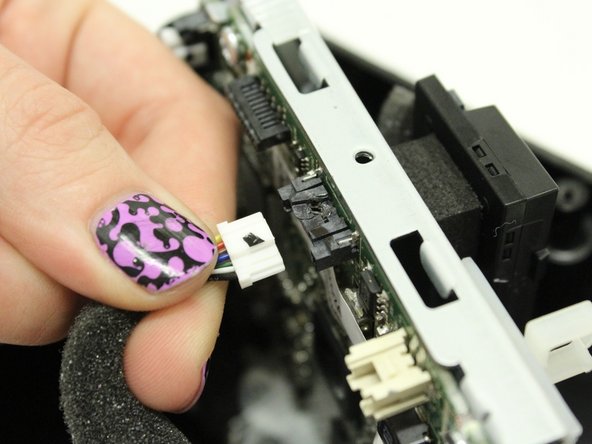

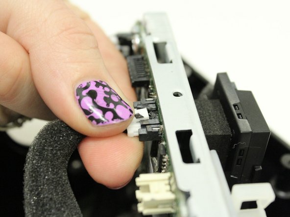

    • Disconnect white connector by pushing down on the release tab while gently pulling the connector free from the socket.
    • Remove wiring harness and set aside.
    • The other connectors in the wiring harness should already be free from previous steps.

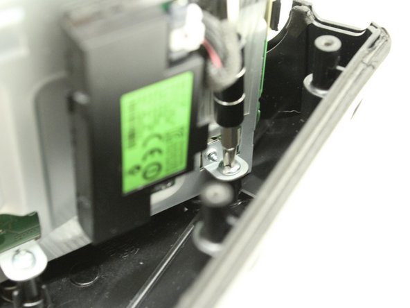

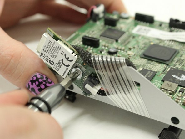

    • Flip the motherboard assembly over and locate the Bluetooth module on the side of the metal frame.
    • Remove the one PH2 Philips screw.
  14. Samsung Radiant 360 R1 Bluetooth Module Replacement: crwdns2935265:014crwdnd2935265:01crwdnd2935265:01crwdne2935265:0
    • Press the white tab while gently pulling the Bluetooth module away from the connector and frame.

Nice write up, but where does one obtain a new Bluetooth module for one of these?
Royce Courtney - crwdns2934203:0crwdne2934203:0
Where can I buy these type of bluetooth module? Ty
Payout PH - crwdns2934203:0crwdne2934203:0
Bluetooth module model is WIBT30D. You can google for it. It cost ~30 euro now
Salar Mahdavi - crwdns2934203:0crwdne2934203:0
