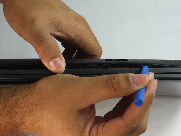

      • Using the blue plastic opening tools, wedge one in between the back panel and the laptop.
      • Carefully remove the back panel..

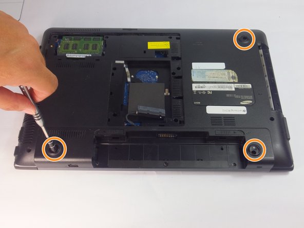

      • Remove the eight 5mm Phillips #0 screws using a Phillips #0 driver.
      • Also remove the three 5mm Phillips #0 using a Phillips #0 driver.

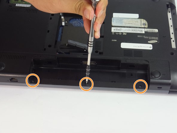

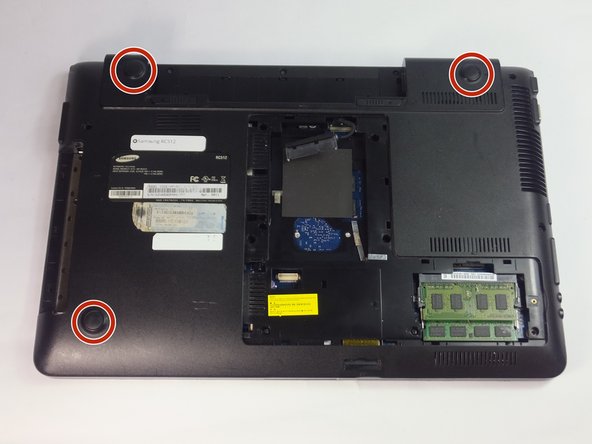

      • Remove three bottom dark covers using tweezers.
      • Remove three 10mm Phillips #0 screws using Phillips #0 driver.

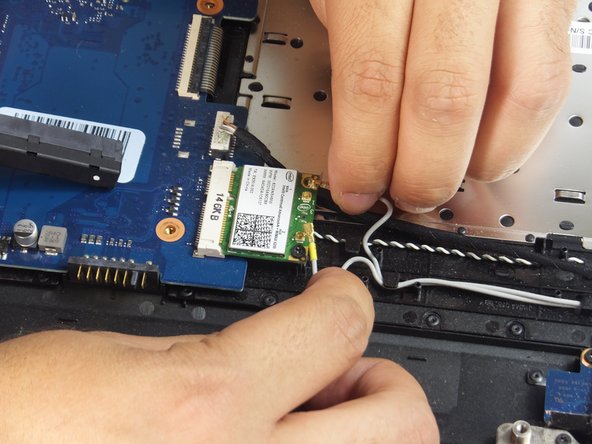

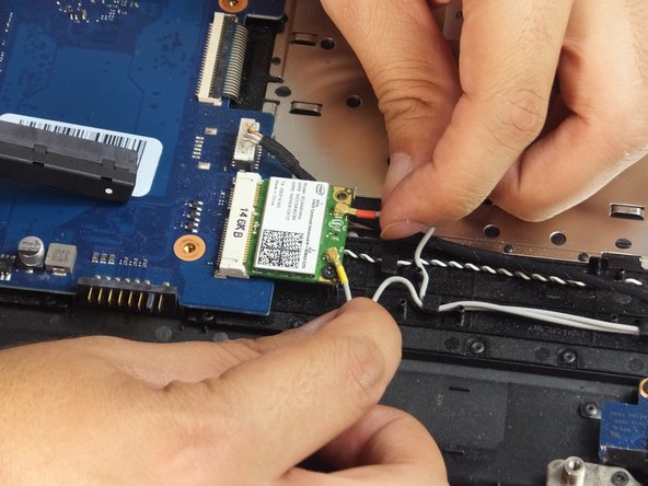

      • Gently lift the connectors from the Wi-Fi card.
    5. Samsung RC512 Wi-Fi Card Replacement: crwdns2935265:013crwdnd2935265:01crwdnd2935265:02crwdne2935265:0 Samsung RC512 Wi-Fi Card Replacement: crwdns2935265:013crwdnd2935265:02crwdnd2935265:02crwdne2935265:0
      • Remove one 5mm Phillips #0 screw using a Phillips #0 driver.
      • The Wi-Fi card will rise up itself after removing the Phillips #0 screw. Pull it out away from the slot.
