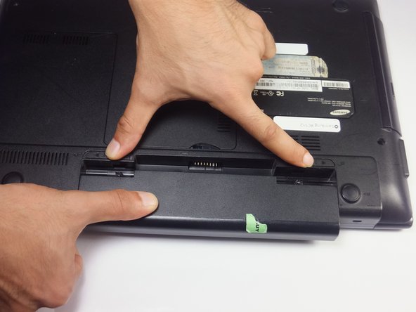

    1. Samsung RC512 Screen Replacement, Battery: crwdns2935265:01crwdnd2935265:01crwdnd2935265:01crwdne2935265:0
      • Place the laptop upside down.
    2. Samsung RC512 Screen Replacement: crwdns2935265:02crwdnd2935265:01crwdnd2935265:02crwdne2935265:0 Samsung RC512 Screen Replacement: crwdns2935265:02crwdnd2935265:02crwdnd2935265:02crwdne2935265:0
      • Locate two notches above the battery.
      • Slide both battery locking notches to either side to remove the battery.
      • Pull the battery out.

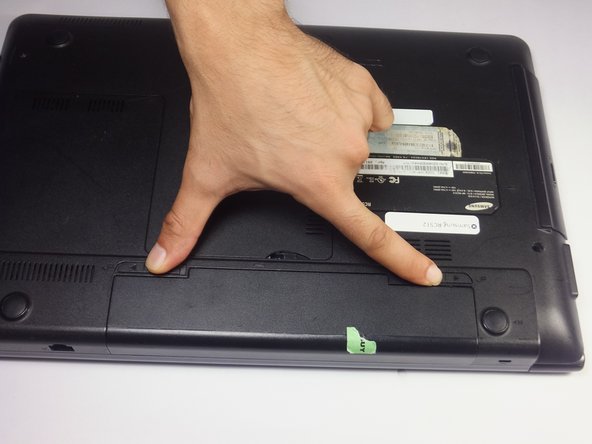

    1. Samsung RC512 Screen Replacement, Screen: crwdns2935265:03crwdnd2935265:01crwdnd2935265:03crwdne2935265:0 Samsung RC512 Screen Replacement, Screen: crwdns2935265:03crwdnd2935265:02crwdnd2935265:03crwdne2935265:0 Samsung RC512 Screen Replacement, Screen: crwdns2935265:03crwdnd2935265:03crwdnd2935265:03crwdne2935265:0
      • The Laptop should be off before removing the battery.

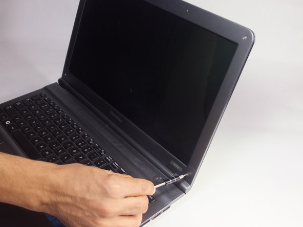

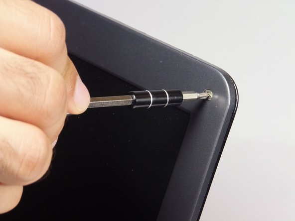

    2. Samsung RC512 Screen Replacement: crwdns2935265:04crwdnd2935265:01crwdnd2935265:03crwdne2935265:0 Samsung RC512 Screen Replacement: crwdns2935265:04crwdnd2935265:02crwdnd2935265:03crwdne2935265:0 Samsung RC512 Screen Replacement: crwdns2935265:04crwdnd2935265:03crwdnd2935265:03crwdne2935265:0
      • Remove the gray covers with tweezers to expose the 4mm screws.
      • Using a Phillips #0 screwdriver, remove the four 4 mm Phillips #0 screws.

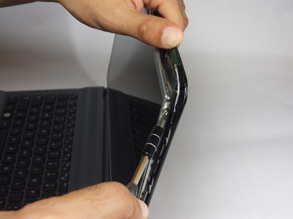

    5. Samsung RC512 Screen Replacement: crwdns2935265:07crwdnd2935265:01crwdnd2935265:03crwdne2935265:0 Samsung RC512 Screen Replacement: crwdns2935265:07crwdnd2935265:02crwdnd2935265:03crwdne2935265:0 Samsung RC512 Screen Replacement: crwdns2935265:07crwdnd2935265:03crwdnd2935265:03crwdne2935265:0
      • Gently lay the LCD onto the keyboard.
      • Do not separate the LCD screen and the back panel from each other. The video connector still connects the two together.
      • Remove the tape that secures the video connector to the LCD screen with tweezers.
      • Grasp the video connector at its base and pull it away from the LCD screen.
      • The only thing holding the screen will be the clear tape causing it to come out easily.
