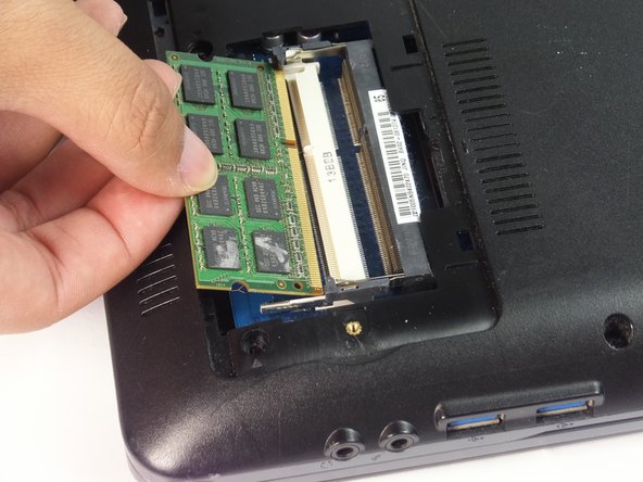

    1. Samsung RC512 RAM Replacement, RAM: crwdns2935265:04crwdnd2935265:01crwdnd2935265:01crwdne2935265:0
      • Slide the hinges outwards to release the RAM.
      • RAM will pop up by itself. If not, lift the RAM up to about 45 degrees.
    2. Samsung RC512 RAM Replacement: crwdns2935265:05crwdnd2935265:01crwdnd2935265:02crwdne2935265:0 Samsung RC512 RAM Replacement: crwdns2935265:05crwdnd2935265:02crwdnd2935265:02crwdne2935265:0
      • Carefully slide the RAM away from the slot to remove it.
      • Repeat step 4 to remove another RAM.
