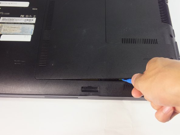

    1. Samsung RC512 Optic Drive Replacement, Back Panel: crwdns2935265:03crwdnd2935265:01crwdnd2935265:03crwdne2935265:0 Samsung RC512 Optic Drive Replacement, Back Panel: crwdns2935265:03crwdnd2935265:02crwdnd2935265:03crwdne2935265:0 Samsung RC512 Optic Drive Replacement, Back Panel: crwdns2935265:03crwdnd2935265:03crwdnd2935265:03crwdne2935265:0
      • Using the Phillips #0 screwdriver, unscrew the one 5mm screw.
      • Using the blue plastic opening tools, wedge one in between the back panel and the laptop.
      • Carefully remove the back panel..

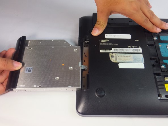

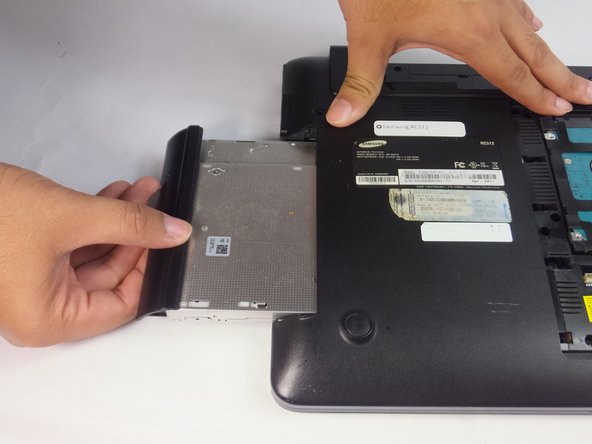

    1. Samsung RC512 Optic Drive Replacement, Optic Drive: crwdns2935265:04crwdnd2935265:01crwdnd2935265:01crwdne2935265:0
      • Remove the 4mm Phillips #0 screw using a Phillips #0 screwdriver.
    2. Samsung RC512 Optic Drive Replacement: crwdns2935265:05crwdnd2935265:01crwdnd2935265:03crwdne2935265:0 Samsung RC512 Optic Drive Replacement: crwdns2935265:05crwdnd2935265:02crwdnd2935265:03crwdne2935265:0 Samsung RC512 Optic Drive Replacement: crwdns2935265:05crwdnd2935265:03crwdnd2935265:03crwdne2935265:0
      • Use the spudger or fingers to gently pull the optical drive out.
      • Slide the optic drive away from the laptop.
