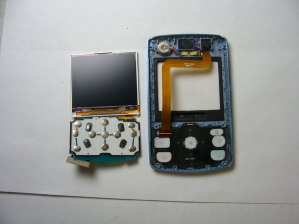

  6. Samsung Propel Screen Replacement: crwdns2935265:08crwdnd2935265:01crwdnd2935265:01crwdne2935265:0
    • Use your hands to remove both the phone buses from the linkages and remove the motherboard.
  7. Samsung Propel Screen Replacement, Screen: crwdns2935265:09crwdnd2935265:01crwdnd2935265:02crwdne2935265:0 Samsung Propel Screen Replacement, Screen: crwdns2935265:09crwdnd2935265:02crwdnd2935265:02crwdne2935265:0
    • Flip and pull eletric band from input.
    • Remove the screen from the front frame.
