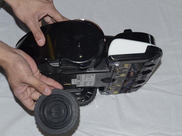

    • Flip the bot onto its side with the wheel you want to remove on top.
  2. Samsung Powerbot R9250 Wheel Replacement: crwdns2935265:02crwdnd2935265:01crwdnd2935265:01crwdne2935265:0
    • Remove the round white cap on the outside of the wheel.
  3. Samsung Powerbot R9250 Wheel Replacement: crwdns2935265:03crwdnd2935265:01crwdnd2935265:01crwdne2935265:0
    • Next, pry and remove the white casing that runs around the back round part of the bot.
  4. Samsung Powerbot R9250 Wheel Replacement: crwdns2935265:04crwdnd2935265:01crwdnd2935265:01crwdne2935265:0
    • Continue until the whole white casing comes off.
  5. Samsung Powerbot R9250 Wheel Replacement: crwdns2935265:05crwdnd2935265:01crwdnd2935265:01crwdne2935265:0
    • For the wheel you want to remove, there is a small square opening on outer black protective layer still around the wheel. Locate the screw that is inside the whole. Remove this screw.
  6. Samsung Powerbot R9250 Wheel Replacement: crwdns2935265:06crwdnd2935265:01crwdnd2935265:02crwdne2935265:0 Samsung Powerbot R9250 Wheel Replacement: crwdns2935265:06crwdnd2935265:02crwdnd2935265:02crwdne2935265:0
    • Pry the black protective layer away from the wheel, and pull the wheel out.
