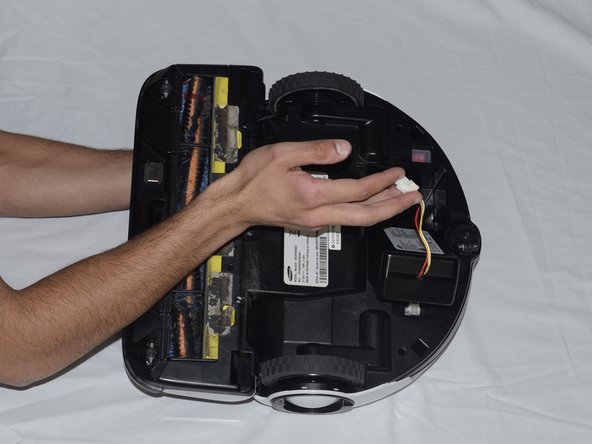

    • On the bottom of the bot, locate the battery lid along the curved edge of the bot.
  2. Samsung Powerbot R9250 Battery Replacement: crwdns2935265:02crwdnd2935265:01crwdnd2935265:02crwdne2935265:0 Samsung Powerbot R9250 Battery Replacement: crwdns2935265:02crwdnd2935265:02crwdnd2935265:02crwdne2935265:0
    • Unscrew each of the two screws and remove the lid to expose the battery.
  3. Samsung Powerbot R9250 Battery Replacement: crwdns2935265:03crwdnd2935265:01crwdnd2935265:01crwdne2935265:0

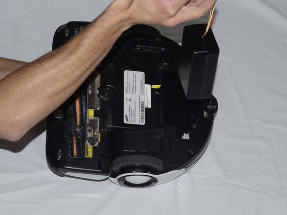

    • Follow the wires to find the small white box next to the battery.
  4. Samsung Powerbot R9250 Battery Replacement: crwdns2935265:04crwdnd2935265:01crwdnd2935265:01crwdne2935265:0
    • On the side of the white box facing the battery, find the rigid tab.
  5. Samsung Powerbot R9250 Battery Replacement: crwdns2935265:05crwdnd2935265:01crwdnd2935265:03crwdne2935265:0 Samsung Powerbot R9250 Battery Replacement: crwdns2935265:05crwdnd2935265:02crwdnd2935265:03crwdne2935265:0 Samsung Powerbot R9250 Battery Replacement: crwdns2935265:05crwdnd2935265:03crwdnd2935265:03crwdne2935265:0
    • Push this tab into the white box, and pull the wires up. This releases the wire from the white box, allowing you to fully remove the battery.
