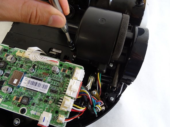

    • Remove the three 5mm Phillips #1 screws in the holes around the vacuum motor.
  12. Samsung POWERbot VR9000 Vacuum Motor Replacement: crwdns2935265:012crwdnd2935265:01crwdnd2935265:02crwdne2935265:0 Samsung POWERbot VR9000 Vacuum Motor Replacement: crwdns2935265:012crwdnd2935265:02crwdnd2935265:02crwdne2935265:0

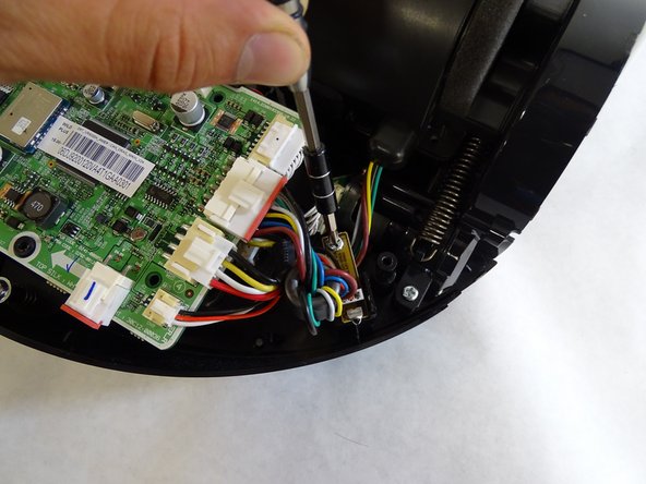

    • Remove the 5mm Phillips #1 screw on the peg to the right of the circuit board.

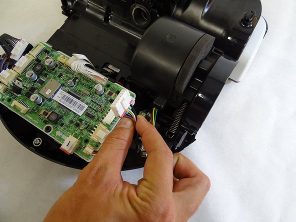

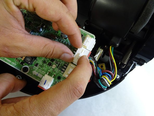

  13. Samsung POWERbot VR9000 Vacuum Motor Replacement: crwdns2935265:013crwdnd2935265:01crwdnd2935265:03crwdne2935265:0 Samsung POWERbot VR9000 Vacuum Motor Replacement: crwdns2935265:013crwdnd2935265:02crwdnd2935265:03crwdne2935265:0 Samsung POWERbot VR9000 Vacuum Motor Replacement: crwdns2935265:013crwdnd2935265:03crwdnd2935265:03crwdne2935265:0
    • Detach the largest circuit connector on the right side by pressing down gently on the right end of the clip and pulling the connector out.
    • Pull the connector out by the top and bottom of the white piece and not by the wires.
