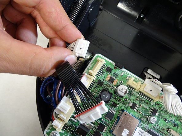

    • Detach the wider circuit connector by pressing down gently on the left end of the clip and pulling the connector out.
    • Pull the connector out by the top and bottom of the white piece and not by the wires.

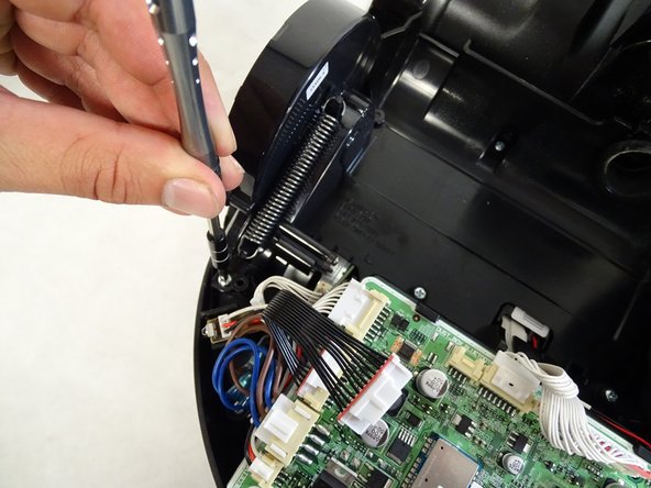

    • Remove the two 5mm Phillips #1 screws in the holes closest to the left wheel.

    • Detach the top-most circuit connector on the left side by pressing down gently on the left end of the clip and pulling the connector out.

    • Remove the driving wheel assembly from the POWERbot by grabbing the wheel and lifting upwards.

Thank you for the usefull instructions. The problem was the wheel engine broken. I’ve been surprised that it was not brushless. Now I will try to fix it. Have a nice time

Thank you for your instructions. I open it up and clean the left wheel decoder by blowing air thru it. Put it back and it run as new. Thank you again.
