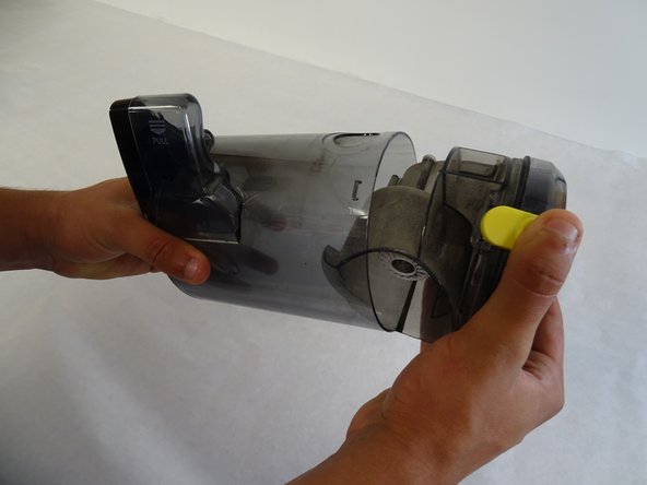

    • Push down on the yellow button to remove the dustbin cover.
  4. Samsung POWERbot VR9000 Filter Replacement: crwdns2935265:04crwdnd2935265:01crwdnd2935265:03crwdne2935265:0 Samsung POWERbot VR9000 Filter Replacement: crwdns2935265:04crwdnd2935265:02crwdnd2935265:03crwdne2935265:0 Samsung POWERbot VR9000 Filter Replacement: crwdns2935265:04crwdnd2935265:03crwdnd2935265:03crwdne2935265:0

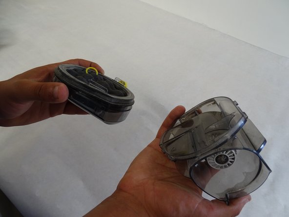

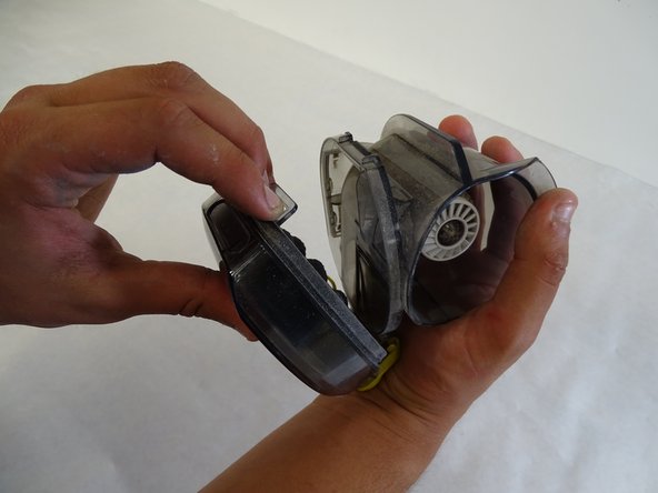

    • Separate the dustbin cover from the filter.
  5. Samsung POWERbot VR9000 Filter Replacement: crwdns2935265:05crwdnd2935265:01crwdnd2935265:02crwdne2935265:0 Samsung POWERbot VR9000 Filter Replacement: crwdns2935265:05crwdnd2935265:02crwdnd2935265:02crwdne2935265:0

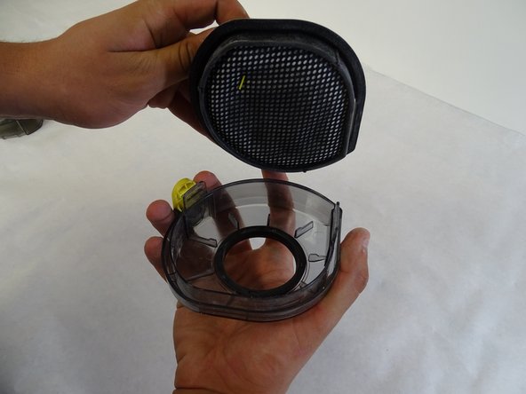

    • Pull gently on the yellow tab to remove the filter from the cover.
  6. Samsung POWERbot VR9000 Filter Replacement: crwdns2935265:06crwdnd2935265:01crwdnd2935265:01crwdne2935265:0
    • The filter is removed. You can dispose of collected dust or rinse the filter with warm water before replacing.
