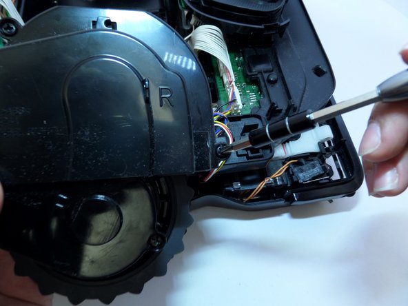

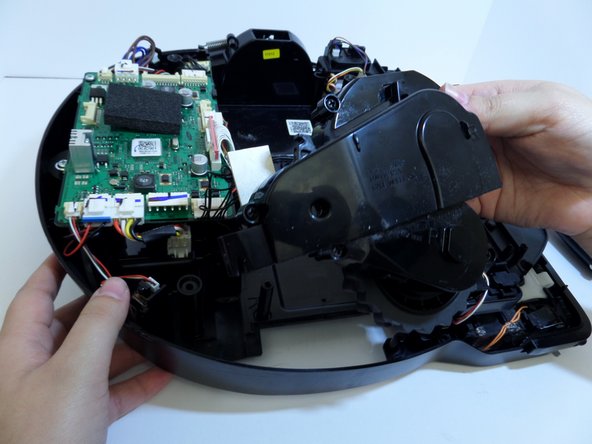

  15. Samsung POWERbot R7070 Right Driving Wheel Replacement: crwdns2935265:015crwdnd2935265:01crwdnd2935265:02crwdne2935265:0 Samsung POWERbot R7070 Right Driving Wheel Replacement: crwdns2935265:015crwdnd2935265:02crwdnd2935265:02crwdne2935265:0
    • Remove the screw securing the black plastic piece to the right of the wheel casing.
    • This piece is not part of the wheel casing but must be unscrewed to remove the wheel casing.
    • Lift wheel and wheel casing out of vacuum base.

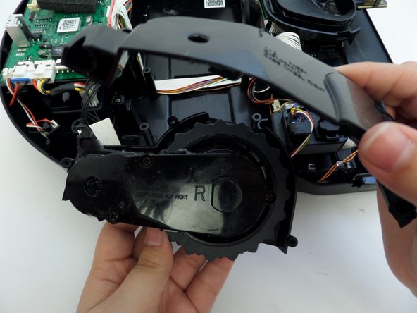

  16. Samsung POWERbot R7070 Right Driving Wheel Replacement: crwdns2935265:016crwdnd2935265:01crwdnd2935265:02crwdne2935265:0 Samsung POWERbot R7070 Right Driving Wheel Replacement: crwdns2935265:016crwdnd2935265:02crwdnd2935265:02crwdne2935265:0
    • Remove the three screws fastening the two halves of the wheel casing together.

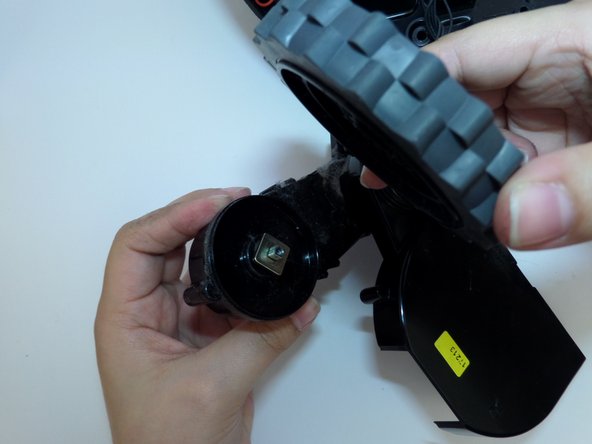

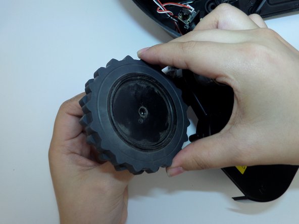

  19. Samsung POWERbot R7070 Right Driving Wheel Replacement: crwdns2935265:019crwdnd2935265:01crwdnd2935265:03crwdne2935265:0 Samsung POWERbot R7070 Right Driving Wheel Replacement: crwdns2935265:019crwdnd2935265:02crwdnd2935265:03crwdne2935265:0 Samsung POWERbot R7070 Right Driving Wheel Replacement: crwdns2935265:019crwdnd2935265:03crwdnd2935265:03crwdne2935265:0
    • Unscrew the black 1 cm screw securing the center of the wheel.
    • Remove the wheel.
