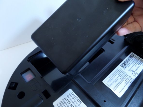

  3. Samsung POWERbot R7070 Left Driving Wheel  Replacement: crwdns2935265:03crwdnd2935265:01crwdnd2935265:01crwdne2935265:0
    • Lift the cover plate to expose the battery.
  4. Samsung POWERbot R7070 Left Driving Wheel  Replacement: crwdns2935265:04crwdnd2935265:01crwdnd2935265:02crwdne2935265:0 Samsung POWERbot R7070 Left Driving Wheel  Replacement: crwdns2935265:04crwdnd2935265:02crwdnd2935265:02crwdne2935265:0
    • Using one hand, pinch the white plastic connector where the battery's wiring connects the POWERbot. Pull up to disconnect.
  5. Samsung POWERbot R7070 Left Driving Wheel  Replacement: crwdns2935265:05crwdnd2935265:01crwdnd2935265:02crwdne2935265:0 Samsung POWERbot R7070 Left Driving Wheel  Replacement: crwdns2935265:05crwdnd2935265:02crwdnd2935265:02crwdne2935265:0
    • Lift the battery from the right side, up and out of its compartment.

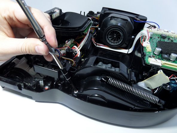

  6. Samsung POWERbot R7070 Left Driving Wheel  Replacement, Motor: crwdns2935265:06crwdnd2935265:01crwdnd2935265:02crwdne2935265:0 Samsung POWERbot R7070 Left Driving Wheel  Replacement, Motor: crwdns2935265:06crwdnd2935265:02crwdnd2935265:02crwdne2935265:0
    • Unscrew the two silver 1.5 cm screws on the left and right side of the battery compartment.
    • Remove the two 1.5 cm screws above the yellow sliding lock tabs.
    • Remove the two 1.2 cm screws in the brush compartment.

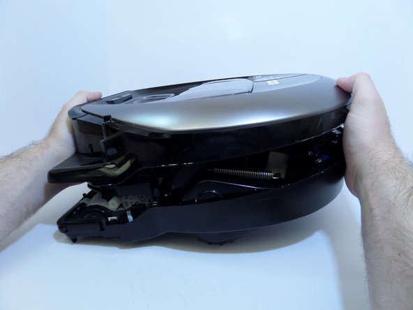

  7. Samsung POWERbot R7070 Left Driving Wheel  Replacement: crwdns2935265:07crwdnd2935265:01crwdnd2935265:02crwdne2935265:0 Samsung POWERbot R7070 Left Driving Wheel  Replacement: crwdns2935265:07crwdnd2935265:02crwdnd2935265:02crwdne2935265:0
    • With moderate force, separate the silver top from the black bottom of the vacuum.
    • The cover will only separate a few inches as the two halves are connected by wires.

    • Remove the four 1.2 cm screws.
    • Remove the single 0.8 cm screw.

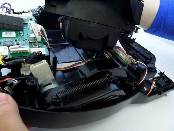

  12. Samsung POWERbot R7070 Left Driving Wheel  Replacement: crwdns2935265:012crwdnd2935265:01crwdnd2935265:01crwdne2935265:0
    • Remove the two 1.5 cm screws on the motor chamber.
  13. Samsung POWERbot R7070 Left Driving Wheel  Replacement: crwdns2935265:013crwdnd2935265:01crwdnd2935265:02crwdne2935265:0 Samsung POWERbot R7070 Left Driving Wheel  Replacement: crwdns2935265:013crwdnd2935265:02crwdnd2935265:02crwdne2935265:0
    • Lift the motor by grabbing the body of the motor, lifting upward.
    • With the screws removed from the motor chamber the top of the motor chamber will pop open.

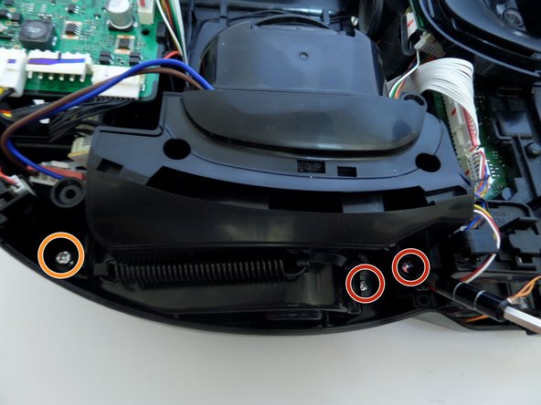

  14. Samsung POWERbot R7070 Left Driving Wheel  Replacement, Left Driving Wheel: crwdns2935265:014crwdnd2935265:01crwdnd2935265:02crwdne2935265:0 Samsung POWERbot R7070 Left Driving Wheel  Replacement, Left Driving Wheel: crwdns2935265:014crwdnd2935265:02crwdnd2935265:02crwdne2935265:0
    • Unscrew the two screws securing the left and right ends of the wheel casing to the base of the vacuum.

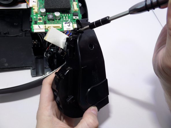

  15. Samsung POWERbot R7070 Left Driving Wheel  Replacement: crwdns2935265:015crwdnd2935265:01crwdnd2935265:01crwdne2935265:0
    • Unscrew the screws securing the black plastic piece to the left of the wheel casing.
    • This piece is not part of the wheel casing but must be moved out of the way to remove the wheel.
    • Lift the wheel casing out of the vacuum base.

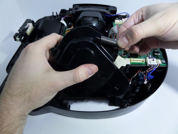

  16. Samsung POWERbot R7070 Left Driving Wheel  Replacement: crwdns2935265:016crwdnd2935265:01crwdnd2935265:02crwdne2935265:0 Samsung POWERbot R7070 Left Driving Wheel  Replacement: crwdns2935265:016crwdnd2935265:02crwdnd2935265:02crwdne2935265:0
    • Arrange the wheel so that the spring is fully retracted.
    • Unhook one edge of the spring by carefully pulling the spring towards the hook.
    • With the spring unhooked, remove the spring from the wheel casing.

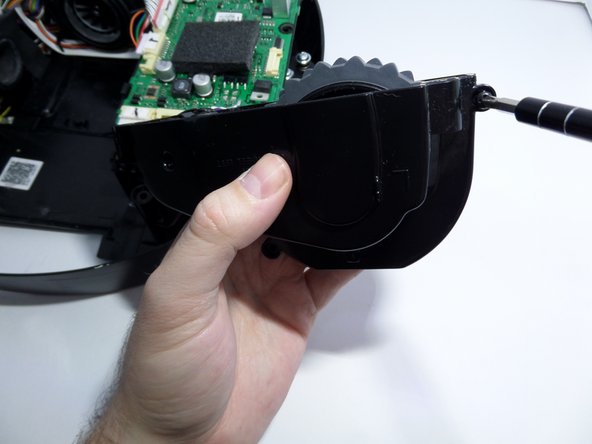

  17. Samsung POWERbot R7070 Left Driving Wheel  Replacement: crwdns2935265:017crwdnd2935265:01crwdnd2935265:03crwdne2935265:0 Samsung POWERbot R7070 Left Driving Wheel  Replacement: crwdns2935265:017crwdnd2935265:02crwdnd2935265:03crwdne2935265:0 Samsung POWERbot R7070 Left Driving Wheel  Replacement: crwdns2935265:017crwdnd2935265:03crwdnd2935265:03crwdne2935265:0
    • Remove the screws that are fastening the two halves of the wheel casing together.
  18. Samsung POWERbot R7070 Left Driving Wheel  Replacement: crwdns2935265:018crwdnd2935265:01crwdnd2935265:02crwdne2935265:0 Samsung POWERbot R7070 Left Driving Wheel  Replacement: crwdns2935265:018crwdnd2935265:02crwdnd2935265:02crwdne2935265:0
    • Open wheel casing.

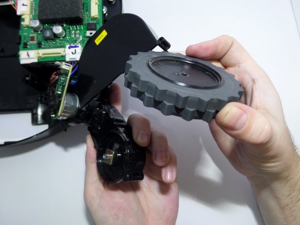

    • Unscrew the black 1 cm screw securing the center of the wheel to the remaining half of the wheel casing.
  20. Samsung POWERbot R7070 Left Driving Wheel  Replacement: crwdns2935265:020crwdnd2935265:01crwdnd2935265:02crwdne2935265:0 Samsung POWERbot R7070 Left Driving Wheel  Replacement: crwdns2935265:020crwdnd2935265:02crwdnd2935265:02crwdne2935265:0
    • Remove the wheel.
