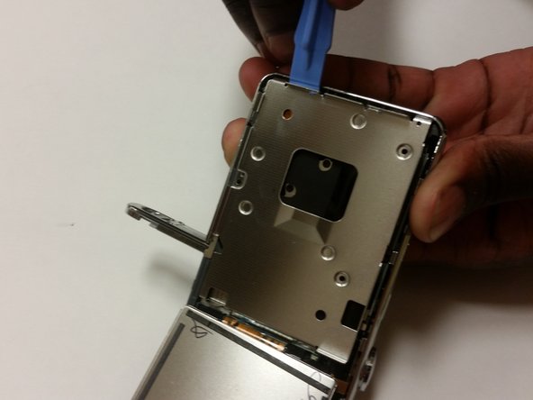

  2. Samsung PL200 Motherboard Replacement: crwdns2935265:02crwdnd2935265:01crwdnd2935265:03crwdne2935265:0 Samsung PL200 Motherboard Replacement: crwdns2935265:02crwdnd2935265:02crwdnd2935265:03crwdne2935265:0 Samsung PL200 Motherboard Replacement: crwdns2935265:02crwdnd2935265:03crwdnd2935265:03crwdne2935265:0
    • Use the Plastic Opening Tool and your finger to pry off and remove the external cover.

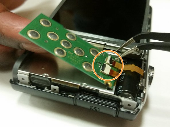

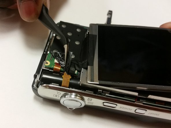

    • Remove the 3mm screw holding the circuit board using the #000 Philips Screwdriver.
    • Remove any tape on the circuit board and screen.
    • Using Tweezers, unplug the wires from the circuit board and remove it.

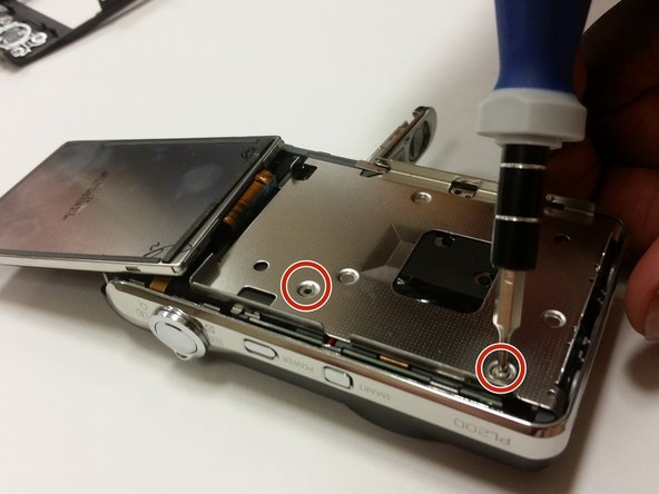

  4. Samsung PL200 Motherboard Replacement: crwdns2935265:04crwdnd2935265:01crwdnd2935265:02crwdne2935265:0 Samsung PL200 Motherboard Replacement: crwdns2935265:04crwdnd2935265:02crwdnd2935265:02crwdne2935265:0
    • Flip the LCD screen forward and remove the two 3mm screws beneath it using the #000 Phillips Screwdriver.
    • Remove the metal brace using the Plastic Opening Tool.

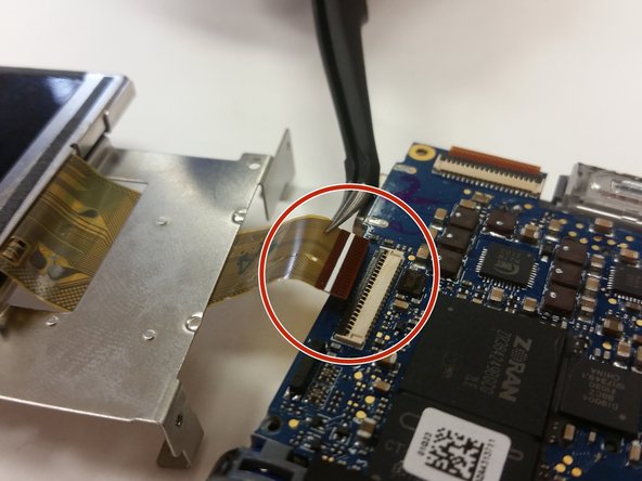

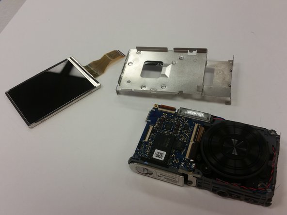

  5. Samsung PL200 Motherboard Replacement: crwdns2935265:05crwdnd2935265:01crwdnd2935265:02crwdne2935265:0 Samsung PL200 Motherboard Replacement: crwdns2935265:05crwdnd2935265:02crwdnd2935265:02crwdne2935265:0
    • Lift the black latch where the screen plugs into the motherboard and pull the cord to remove the screen
    • Separate the screen and the metal brace from the camera body.

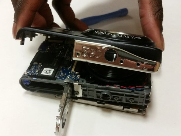

  6. Samsung PL200 Motherboard Replacement: crwdns2935265:06crwdnd2935265:01crwdnd2935265:01crwdne2935265:0
    • Remove the front cover of the camera using your fingers and the Plastic Opening Tool.

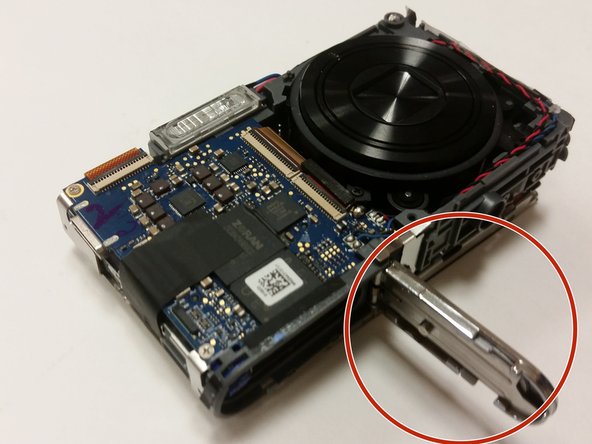

    • Set the screen and metal brace aside
    • Open the camera's battery cover.

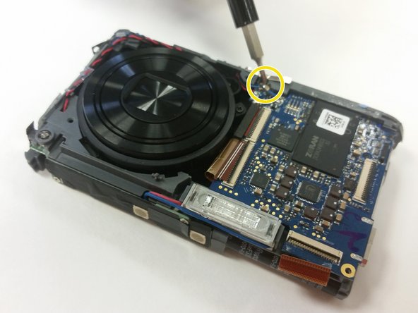

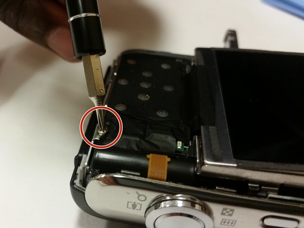

  8. Samsung PL200 Motherboard Replacement: crwdns2935265:08crwdnd2935265:01crwdnd2935265:01crwdne2935265:0
    • Using the #000 Phillips Screwdriver, remove the two 3mm screws holding the motherboard in place.
    • There may be tape still on the motherboard, if so, remove it.
  9. Samsung PL200 Motherboard Replacement: crwdns2935265:09crwdnd2935265:01crwdnd2935265:03crwdne2935265:0 Samsung PL200 Motherboard Replacement: crwdns2935265:09crwdnd2935265:02crwdnd2935265:03crwdne2935265:0 Samsung PL200 Motherboard Replacement: crwdns2935265:09crwdnd2935265:03crwdnd2935265:03crwdne2935265:0
    • Use the Tweezers to remove the tape from bottom of the camera
    • Use the Tweezers to disconnect the lens unit cord that is at the bottom of the camera from the motherboard.
    • Remove the last 3mm screw that holds the motherboard in place.

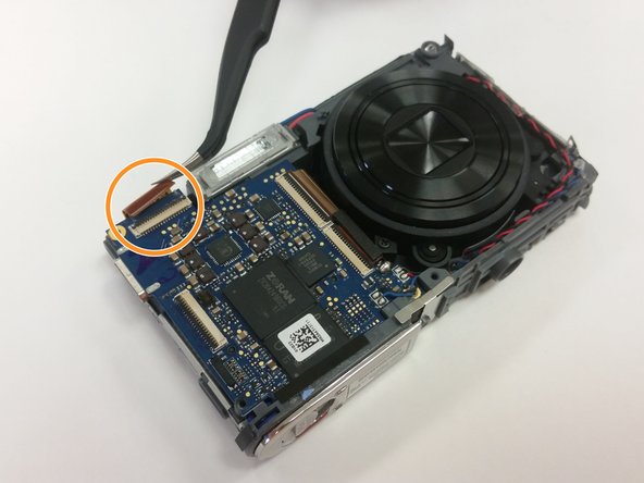

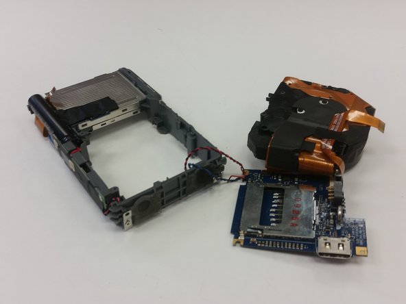

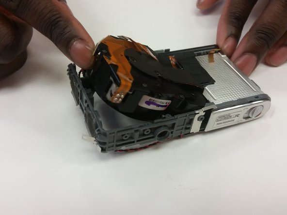

  10. Samsung PL200 Motherboard Replacement: crwdns2935265:010crwdnd2935265:01crwdnd2935265:03crwdne2935265:0 Samsung PL200 Motherboard Replacement: crwdns2935265:010crwdnd2935265:02crwdnd2935265:03crwdne2935265:0 Samsung PL200 Motherboard Replacement: crwdns2935265:010crwdnd2935265:03crwdnd2935265:03crwdne2935265:0
    • Use the Tweezers to unplug the small lens unit cord from the camera frame on the back side of the camera.
    • Gently lift the lens unit from the frame.
    • Separate the lens unit, motherboard, and camera.

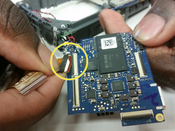

  11. Samsung PL200 Motherboard Replacement: crwdns2935265:011crwdnd2935265:01crwdnd2935265:03crwdne2935265:0 Samsung PL200 Motherboard Replacement: crwdns2935265:011crwdnd2935265:02crwdnd2935265:03crwdne2935265:0 Samsung PL200 Motherboard Replacement: crwdns2935265:011crwdnd2935265:03crwdnd2935265:03crwdne2935265:0

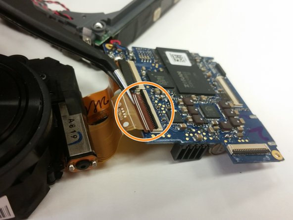

    • Use the Tweezers to remove the small cord from motherboard.
    • Use the Tweezers to remove the first large lens unit cord from the motherboard.
    • Use the Tweezers to remove the second large lens unit cord from the motherboard.

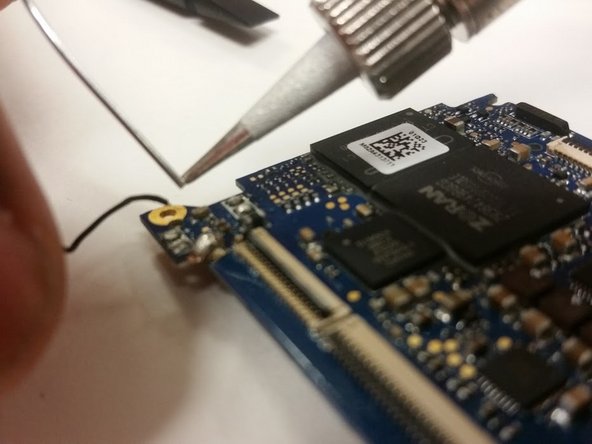

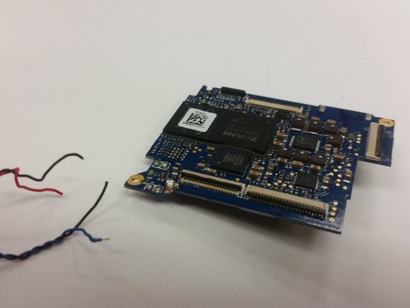

  12. Samsung PL200 Motherboard Replacement: crwdns2935265:012crwdnd2935265:01crwdnd2935265:02crwdne2935265:0 Samsung PL200 Motherboard Replacement: crwdns2935265:012crwdnd2935265:02crwdnd2935265:02crwdne2935265:0
    • Desolder the four wires from the old motherboard.
  13. Samsung PL200 Motherboard Replacement: crwdns2935265:013crwdnd2935265:01crwdnd2935265:02crwdne2935265:0 Samsung PL200 Motherboard Replacement: crwdns2935265:013crwdnd2935265:02crwdnd2935265:02crwdne2935265:0
    • Last, solder on a functional motherboard at this stage and reassemble the device.
