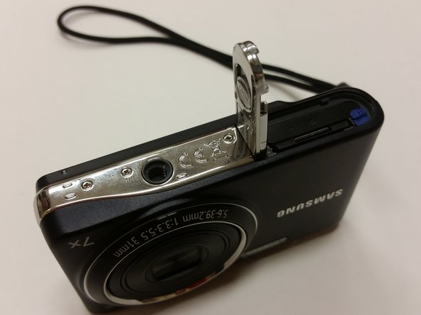

    • Flip Samsung PL200 over to access battery/SD card compartment on the bottom. There is a sliding release button (labeled 'OPEN') that can be slid sideways to open the battery/SD card compartment.
    • Slide this button in the direction that the arrow is pointing to release and open the spring loaded battery/SD card compartment door. Once opened, the battery should be visible.

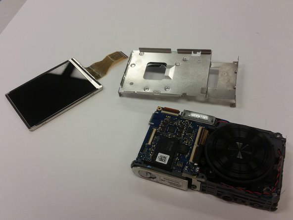

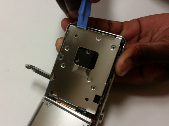

  7. Samsung PL200 Lens Replacement: crwdns2935265:07crwdnd2935265:01crwdnd2935265:02crwdne2935265:0 Samsung PL200 Lens Replacement: crwdns2935265:07crwdnd2935265:02crwdnd2935265:02crwdne2935265:0
    • Flip the LCD screen forward and remove the two 3 mm screws holding the metal midframe using a Phillips #000 screwdriver.
    • Remove the midframe using an opening tool.
  8. Samsung PL200 Lens Replacement: crwdns2935265:08crwdnd2935265:01crwdnd2935265:01crwdne2935265:0
    • Remove the front cover. It will come off fairly easily.
  9. Samsung PL200 Lens Replacement: crwdns2935265:09crwdnd2935265:01crwdnd2935265:02crwdne2935265:0 Samsung PL200 Lens Replacement: crwdns2935265:09crwdnd2935265:02crwdnd2935265:02crwdne2935265:0
    • Lift the black strip and the ribbon will easily come out.
    • After doing this, the LCD screen will be separated from the camera.

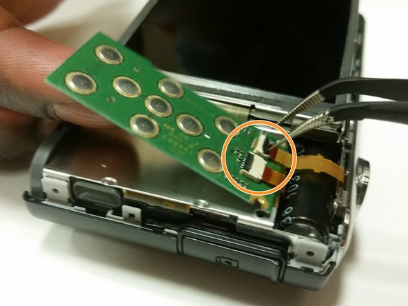

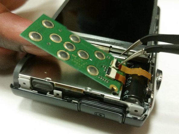

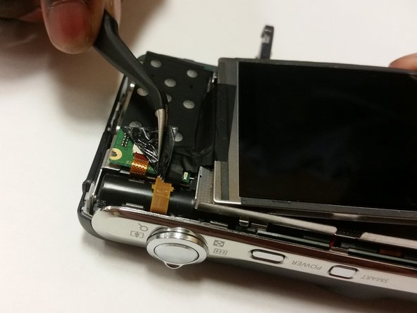

  14. Samsung PL200 Lens Replacement: crwdns2935265:014crwdnd2935265:01crwdnd2935265:03crwdne2935265:0 Samsung PL200 Lens Replacement: crwdns2935265:014crwdnd2935265:02crwdnd2935265:03crwdne2935265:0 Samsung PL200 Lens Replacement: crwdns2935265:014crwdnd2935265:03crwdnd2935265:03crwdne2935265:0
    • Remove the single 3 mm screw securing the circuit board with a Phillips #000 screwdriver.
    • Remove any leftover tape on the circuit board and screen.
    • Unplug and remove the wires from the circuit board using a set of tweezers.

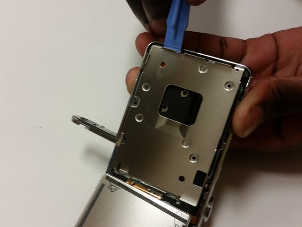

  15. Samsung PL200 Lens Replacement: crwdns2935265:015crwdnd2935265:01crwdnd2935265:02crwdne2935265:0 Samsung PL200 Lens Replacement: crwdns2935265:015crwdnd2935265:02crwdnd2935265:02crwdne2935265:0
    • Flip the LCD screen forward and out to the side.
    • Use a Phillips #000 screwdriver to remove the two 3 mm screws beneath the LCD screen.
    • Remove the metal brace using the Plastic Opening Tool.

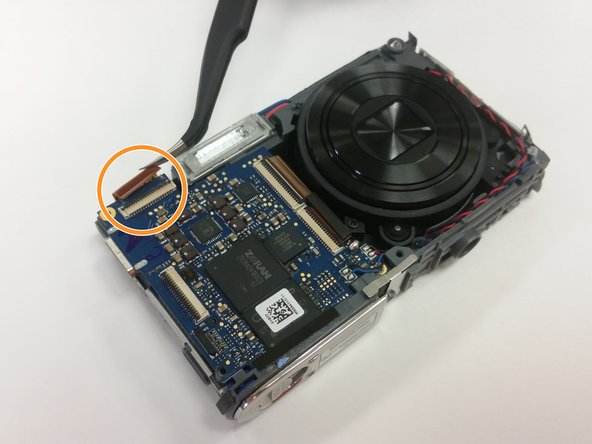

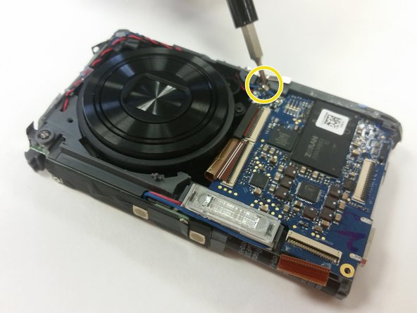

  20. Samsung PL200 Lens Replacement: crwdns2935265:020crwdnd2935265:01crwdnd2935265:03crwdne2935265:0 Samsung PL200 Lens Replacement: crwdns2935265:020crwdnd2935265:02crwdnd2935265:03crwdne2935265:0 Samsung PL200 Lens Replacement: crwdns2935265:020crwdnd2935265:03crwdnd2935265:03crwdne2935265:0
    • Use tweezers to remove the tape from the bottom of the camera.
    • Then use the tweezers to disconnect the lens unit cord at the bottom of the camera from the motherboard.
    • Remove the last 3 mm screw securing the motherboard with a Phillips #00 screwdriver.

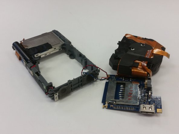

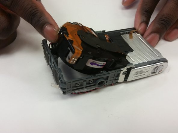

  21. Samsung PL200 Lens Replacement: crwdns2935265:021crwdnd2935265:01crwdnd2935265:03crwdne2935265:0 Samsung PL200 Lens Replacement: crwdns2935265:021crwdnd2935265:02crwdnd2935265:03crwdne2935265:0 Samsung PL200 Lens Replacement: crwdns2935265:021crwdnd2935265:03crwdnd2935265:03crwdne2935265:0
    • Use tweezers to unplug the small lens unit cord from the camera frame on the backside of the camera.
    • Gently lift the lens unit from the frame.
    • Separate the lens unit, motherboard, and camera.

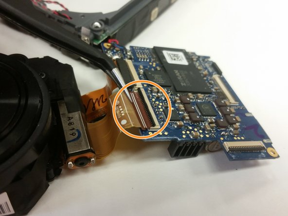

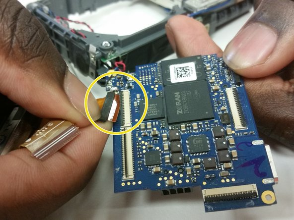

  22. Samsung PL200 Lens Replacement: crwdns2935265:022crwdnd2935265:01crwdnd2935265:03crwdne2935265:0 Samsung PL200 Lens Replacement: crwdns2935265:022crwdnd2935265:02crwdnd2935265:03crwdne2935265:0 Samsung PL200 Lens Replacement: crwdns2935265:022crwdnd2935265:03crwdnd2935265:03crwdne2935265:0
    • Use tweezers to disconnect the small ribbon cable from the motherboard.
    • Then use the tweezers to remove the first large lens unit ribbon cable from the motherboard.
    • Finally, use the tweezers to remove the second large lens unit ribbon cable from the motherboard.
  23. Samsung PL200 Lens Replacement: crwdns2935265:023crwdnd2935265:01crwdnd2935265:01crwdne2935265:0
    • You have now separated the lens unit. Replace it with a functional lens unit at this stage, and reassemble the device.
