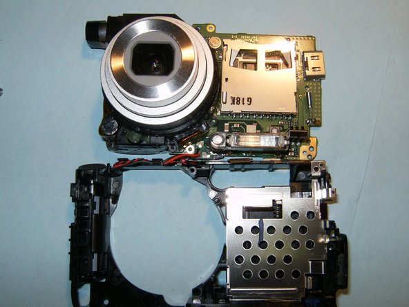

  3. Samsung PL20 Lens Replacement: crwdns2935265:03crwdnd2935265:01crwdnd2935265:03crwdne2935265:0 Samsung PL20 Lens Replacement: crwdns2935265:03crwdnd2935265:02crwdnd2935265:03crwdne2935265:0 Samsung PL20 Lens Replacement: crwdns2935265:03crwdnd2935265:03crwdnd2935265:03crwdne2935265:0
    • Remove the back panel, revealing the LCD screen.
    • Pull the LCD screen out of its holder. Once you have access to the connecting strip, flip the clip upwards releasing the screen completely and remove.

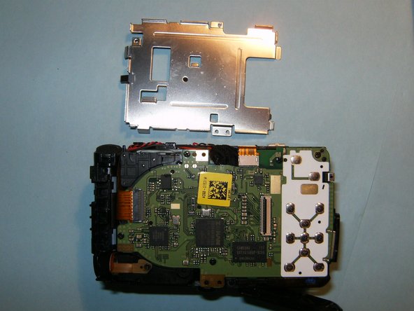

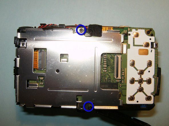

  4. Samsung PL20 Lens Replacement: crwdns2935265:04crwdnd2935265:01crwdnd2935265:03crwdne2935265:0 Samsung PL20 Lens Replacement: crwdns2935265:04crwdnd2935265:02crwdnd2935265:03crwdne2935265:0 Samsung PL20 Lens Replacement: crwdns2935265:04crwdnd2935265:03crwdnd2935265:03crwdne2935265:0
    • Gently pull the front panel from the device.
    • Remove the two screws attaching the LCD screen holder to the device.
    • Remove the screen holder from the rest of the device.

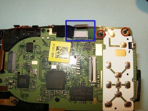

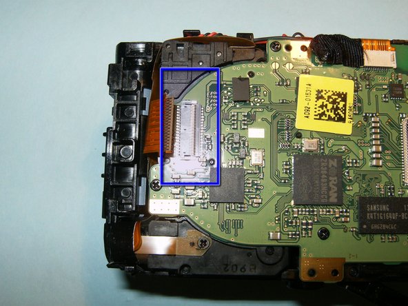

  5. Samsung PL20 Lens Replacement: crwdns2935265:05crwdnd2935265:01crwdnd2935265:03crwdne2935265:0 Samsung PL20 Lens Replacement: crwdns2935265:05crwdnd2935265:02crwdnd2935265:03crwdne2935265:0 Samsung PL20 Lens Replacement: crwdns2935265:05crwdnd2935265:03crwdnd2935265:03crwdne2935265:0
    • Flip the grey clip upwards, releasing the connector from the device.
    • Disconnect the ribbon cable extending from the left side.
    • Disconnect the ribbon cable extending from the button bar.
    • Remove the 2 screws.

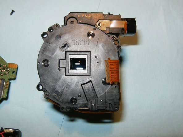

  6. Samsung PL20 Lens Replacement: crwdns2935265:06crwdnd2935265:01crwdnd2935265:03crwdne2935265:0 Samsung PL20 Lens Replacement: crwdns2935265:06crwdnd2935265:02crwdnd2935265:03crwdne2935265:0 Samsung PL20 Lens Replacement: crwdns2935265:06crwdnd2935265:03crwdnd2935265:03crwdne2935265:0
    • Remove these 3 screws. releasing the lens from the logic board.
    • Remove the lens from the logic board.
