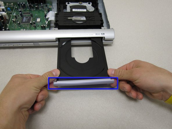

  3. Samsung P241 Front Panel Replacement, Front Panel: crwdns2935265:03crwdnd2935265:01crwdnd2935265:02crwdne2935265:0 Samsung P241 Front Panel Replacement, Front Panel: crwdns2935265:03crwdnd2935265:02crwdnd2935265:02crwdne2935265:0
    • With the front of the DVD player facing you, turn the power on and eject the disc tray.
    • Press down on the disc tray with your thumbs while also pressing up with your pointer finger on the left and right edges of the silver cover. The cover should easily pop up and off the disc tray.
    • Be careful not to crack or bend the disc tray by pulling too hard.
